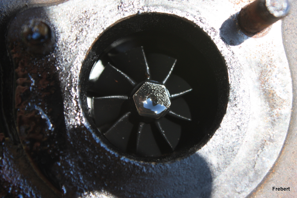

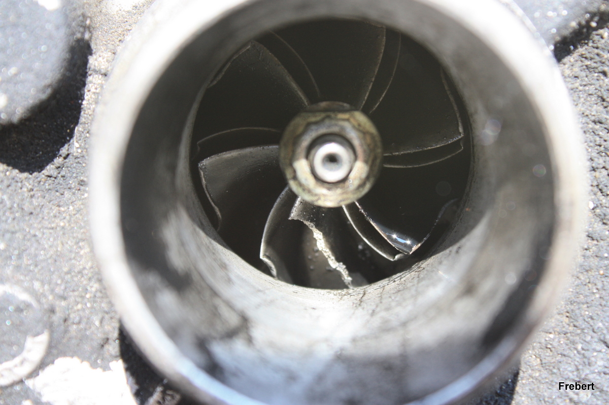

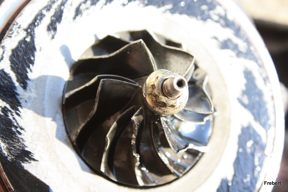

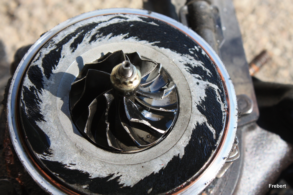

Here are finally some pictures of the wrecked loader...
As you can see, the shovels are quite bent, and one is completely broken off, which I suspect is the cause of the damage. I don't know when or why the shovel broke, and consequently, why the balance was completely off.
You can also imagine how the game was played by looking at the position of the shovels relative to the casing icon_eek.gif ... it must have wobbled quite a bit.
Greetings.

Okay, if I were in your situation, I would have expanded the cooling system again and cleaned it thoroughly until everything was clean.
I once cleaned one while it was still installed, but I later took it out and was really shocked by how much more stuff came out!
And just because you've driven it hard doesn't mean that something isn't still stuck somewhere in the engine and will eventually come loose over time.
