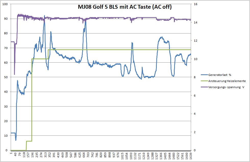

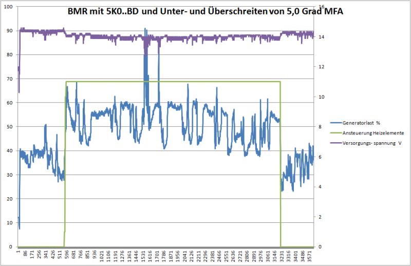

Here's something to look at.
It was actually about whether the auxiliary heaters would turn on, but both of them are working.
The Golf still delivers a significant amount of voltage to the engine control unit (ECU), while the Passat shows a more noticeable drop.

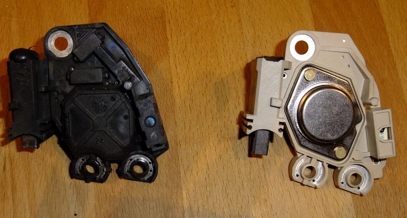

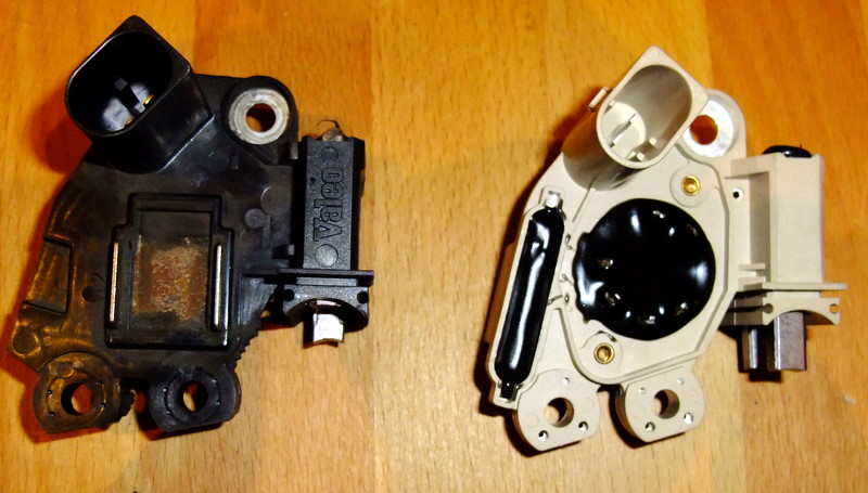

Okay, so, I've now replaced the original Valeo regulator with a cheaper aftermarket unit from Alanko.
Initially, I was very hesitant because Alanko often receives negative reviews online. However, it was the only affordable source for a regulator: 31 euros including shipping, compared to over 50 euros for the original Valeo regulator.
After a phone conversation and incredibly fast shipping, I now have a very positive opinion of Alanko.
Anyway: The quality doesn't seem too bad. The regulator works, and it's better than the old one. Now I'm getting 14.1 volts with the lights and air conditioning on, and 14.2 volts with the air conditioning off.
Here are the front and rear views of the old and new controllers.
