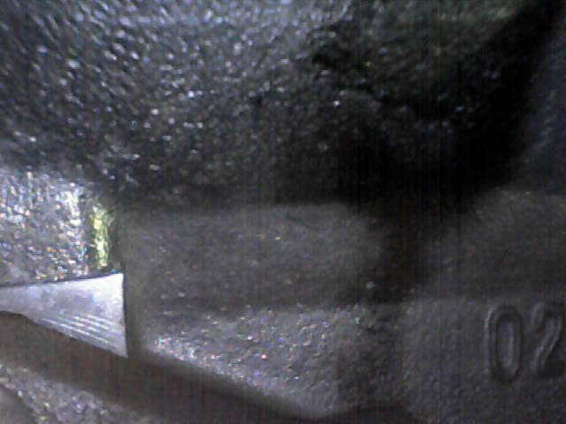

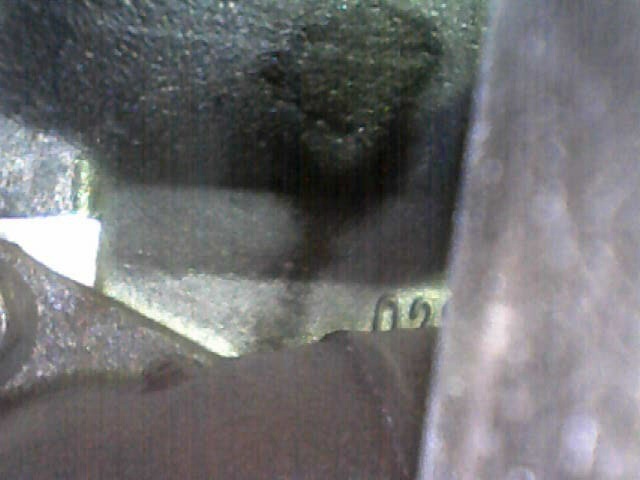

The tandem pump has been checked and is working fine, as is the internal seal. Today, I used my endoscope to inspect the exhaust manifold and was a bit surprised. But take a look for yourselves. The quality isn't great, but it seems it's probably sufficient.

Hi stummel, yes, we all thought the same thing. Even when he was on stage, it looked like there was a tear in his head. Especially since everything around it seemed dry. However, after cleaning the area, nothing more appeared.
I have to say: Unfortunately. Because that would finally be an explanation for my problems with the BMN.
The turbo is driving me crazy with all the noise, and I'm also having starting problems and performance issues every 1000 km. But there are no error codes, and the values I see in VCDS (in my opinion) don't seem unusual.
The only thing we found while changing the valve cover gasket was a completely loose valve cover. After tightening it, the engine ran more smoothly, and the starting problems were also resolved. And so it has been to this day, even after 1400 km.
No matter what is done, it only lasts for a short time...
New catalytic converter, new diesel filter, turbo hoses and seals, valve cover gasket, new intake manifold, new intake hose, air filter.
The tandem pump has been pressure tested: Everything is sealed internally, and the delivery pressure is correct.
I'll probably get under there again sometime soon, but honestly, I'm almost indifferent to it now, which is a shame because I actually like the car.
The only consolation is that my friend is having even less luck with his new E-Class. He had an engine failure at 20,000 km. And now it's his second new Mercedes with an engine failure.
