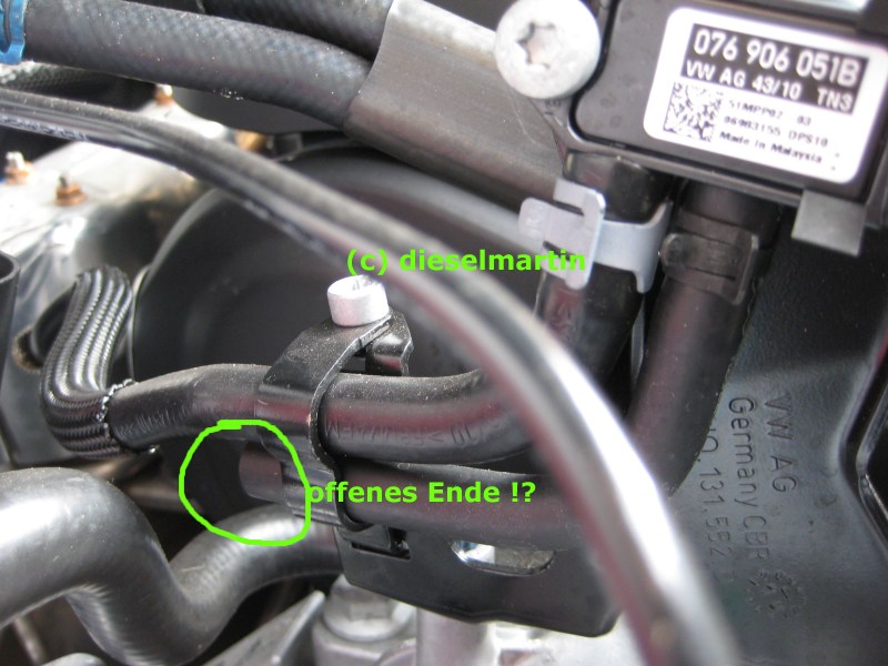

HI.
Does the differential pressure sensor have an ATM connection, meaning an open end, or is it defective?
 Anschluß Differenzdruck Sensor im 7M
 File size:  92.33 KB
 Viewed:  20654 times

Post28-07-2012, 12:31    Subject: Differential Pressure Sensor: How Many Ports? Quote
Hello Martin,
Check this out:
/viewtopic.php?t=25781
Best regards.
Dirk.

Post28-07-2012, 12:59    Subject: Differential Pressure Sensor: How Many Ports? Quote
Great, thanks.
It's a CFFB in a VW Sharan (MJ11).

Post28-07-2012, 14:01    Subject: Differential Pressure Sensor: How Many Ports? Quote
brezelmann01 wrote:
Hello Martin,
Check this out:
Best regards.
Dirk
Just to be on the safe side, I should mention that such a "connection" is not possible or useful if the DPF uses a second connection for the differential pressure sensor.
Therefore, you cannot simply choose freely between the two possible connection types; instead, when performing repairs or modifications, you must use the same variant as before, because the software in the engine control unit expects it.

Post29-07-2012, 15:12    Subject: Differential Pressure Sensor: How Many Ports? Quote
Hi Martin,
With the differential pressure sensor shown here, which has an ATM connection, you can directly measure the back pressure after the turbocharger and before the DPF, and not just the pressure drop across the DPF.
I'm interested in knowing what the back pressure is. Do you have any measurement data from full-throttle runs?
Best regards, Georg.

Post31-08-2012, 21:39    Subject: Differential Pressure Sensor: How Many Ports? Quote
"Could they be doing this to directly measure the pressure for the lambda sensor's pressure compensation, instead of relying on a model?"
They probably already have a complex model for soot loading. Whether they use differential pressure or back pressure depends on whether they model the DPF as a simple container or as a "container with a pipe attached to the back."
However, pressure compensation for the lambda sensor is simplified and improved because it provides a direct measurement, rather than relying on a pressure model at this point, which may be affected by the variable loading of the DPF or be difficult to implement.
