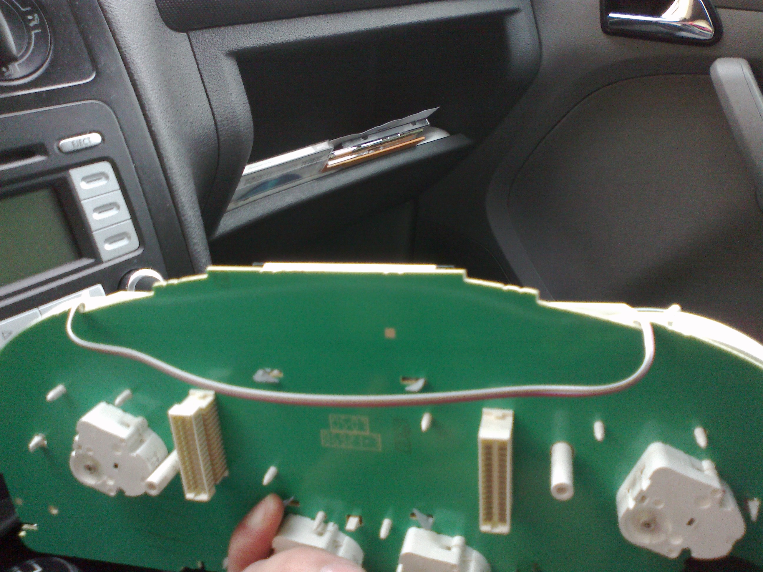

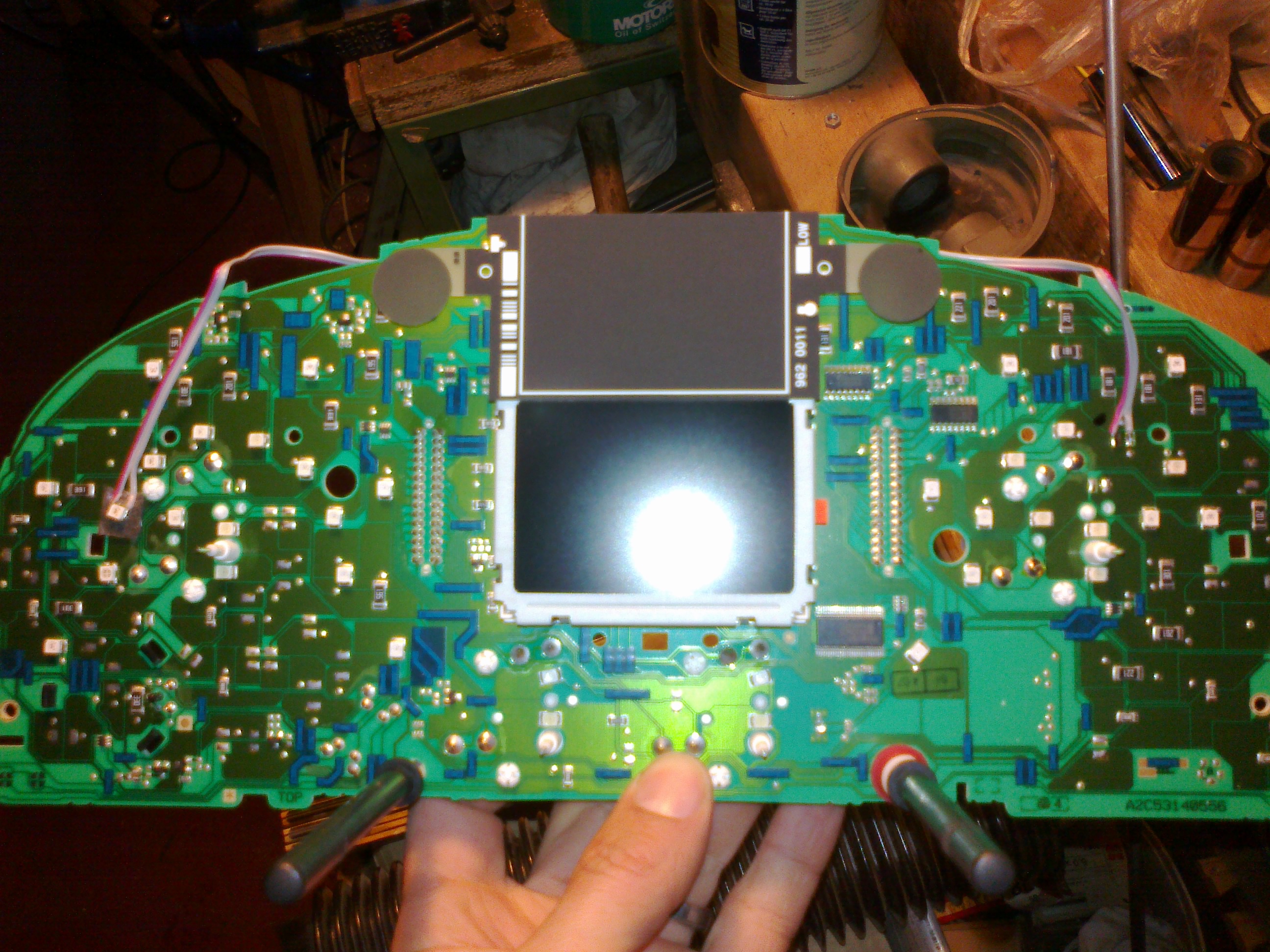

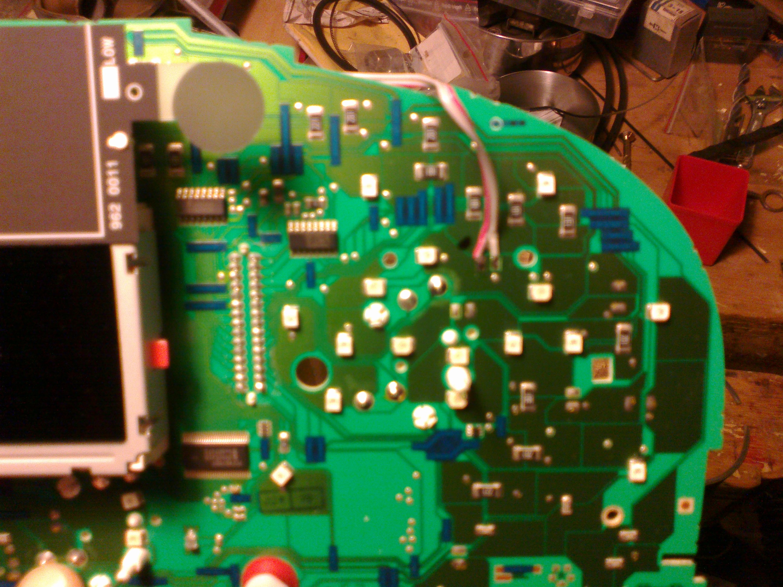

Today, I opened up the instrument cluster and immediately noticed a cable that didn't seem to fit with the rest of the components.
Someone disconnected the ESP (Electronic Stability Program) light and ran a wire to the engine light. The engine light itself was disconnected from its original connection and isolated.
Currently, for an as yet unexplained reason, the soldering point for the engine warning light is always energized (meaning the engine warning light is always on, even though there are no error codes). The ESP warning light illuminates when an engine fault occurs (tested by disconnecting the knock sensor), as well as when the ESP system intervenes or the ESP button is pressed.
The person who modified the system, likely someone familiar with tinkering, probably thought it was more important for the engine light to turn off than the ESP light, and therefore made the modification accordingly.
I'm going to assume that the instrument cluster is faulty.
I will attach the VCDS log again tomorrow and see what messages it contains.
Here are some pictures of the crafting project.

Okay, I've checked the control units again, and everything is fine. There are no unusual entries except for communication errors, which are likely due to me having removed the instrument cluster.
I went for the vehicle inspection, and I passed because the ESP (Electronic Stability Program) light is now working correctly.
I left the engine light on because it keeps coming on constantly.
As mentioned before, there is still an error, as the engine diagnostics are now being displayed by the ESP warning light.
I'll look for a used speedometer with a similar mileage and then test my defective one, and I'll report back later.
