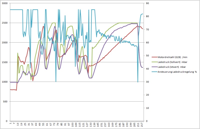

After my BMR was running very smoothly with the new nozzles, I've recently noticed that it doesn't seem to be working at all in higher gears when it's warm.
The situation was absolutely horrifying: with an outside temperature of 40 degrees Celsius and a heavily loaded vehicle, it was impossible to achieve full acceleration without exceeding 2000 rpm.
It wasn't that bad, but the current log looks strange to me (see attachments).
I suspect the LLM.
Okay, bitte gib mir den deutschen Text, den du ĂŒbersetzt haben möchtest.
The peak in the RPM graph in the middle was a lambda test - 1.3 is acceptable.
He was really slow during the last 15 seconds. I had a flat tire on the way, specifically while driving on a rural road.

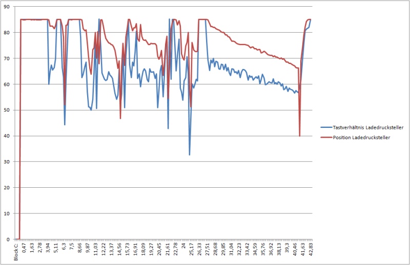

Yes, I also realized too late that I had forgotten about the air masses.
The XLS file is an unprocessed log.
I wanted to save the helpful person the trouble of recreating the chart.
Here's a JPG so you can quickly see what I mean, and then the raw data AND the chart (i.e., the XLS file).
What's very confusing is that the N75 value increases (to 85%) and then immediately decreases again (to 66%). He really doesn't want to, you know.
A classic 3-8-11 log will still be necessary, after all.

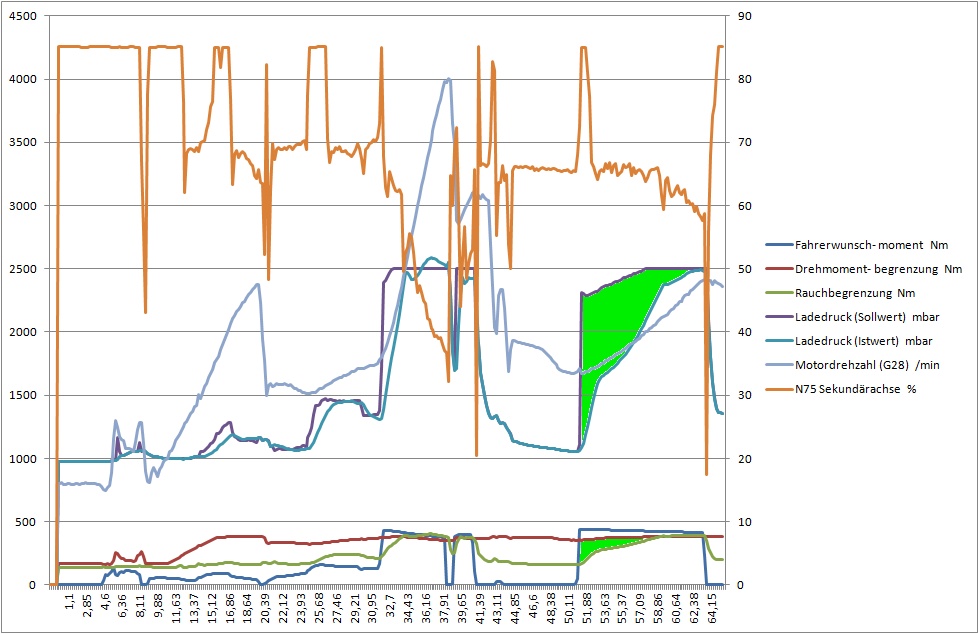

Okay,
Yesterday, it was a bit cooler.
At the end, full throttle - no more of that sudden drop in the LDD (Load Drop Distance) slope, it felt better.

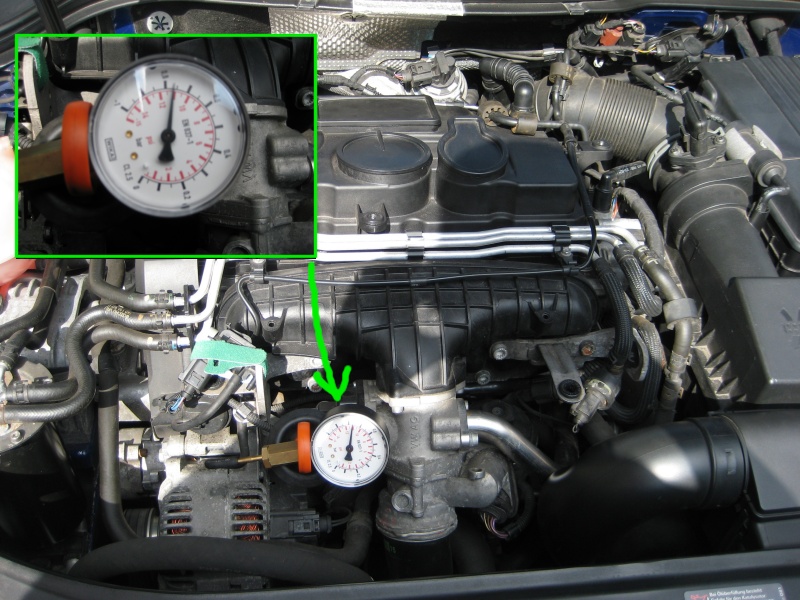

Vacuum pressure at idle: -760 mbar.

The vacuum connection looks good in place, however, to properly assess the tightness, a T-connector should be used at the connection point so that all components are included in the testing loop.
And activate each actuator individually via VCDS in order to check the sealing of the actuators that are inactive in idle mode. So you've also checked the (basic) function of the solenoid valves during the wash cycle.

Here's another short video showing how the vacuum behaves when the N75 valve goes into "actuator diagnosis" mode.
The vacuum pressure was measured at the location shown in the image, specifically at the supply connection of the swirl dampers.
Whether I should, as was once common, occasionally add a memory ball (playfulness).

That was on August 2nd in Alsace - 40 degrees on the windshield temperature gauge (MFA)!!!
Looking at the interaction between the N75 and G581, I'm close to shortening the VTG.
Then, the immediate reduction in the N75 valve opening wouldn't cause such a drastic drop in boost pressure.
Generally, the interaction works well... unless there's a problem that only occurs at high ambient temperatures - regardless of the engine temperature.
Because I have a recent log of the MWB 043, specifically from the last acceptable acceleration.

When comparing the log data (posts from September 6th and 8th), I cannot detect a sharper control signal for the N75 valve in colder weather, especially since the starting speed is different (approximately 1700 rpm versus 1400 rpm). Contrary to that, the N75-TV's torque curve actually decreases at higher RPMs (starting from 1700 rpm), which is common when the control error isn't too high.
It would be interesting to see how the fuel injection amounts (which generate the turbocharger's power) correlate with the actual load demand. Perhaps the heat is causing an additional exhaust system restriction.
