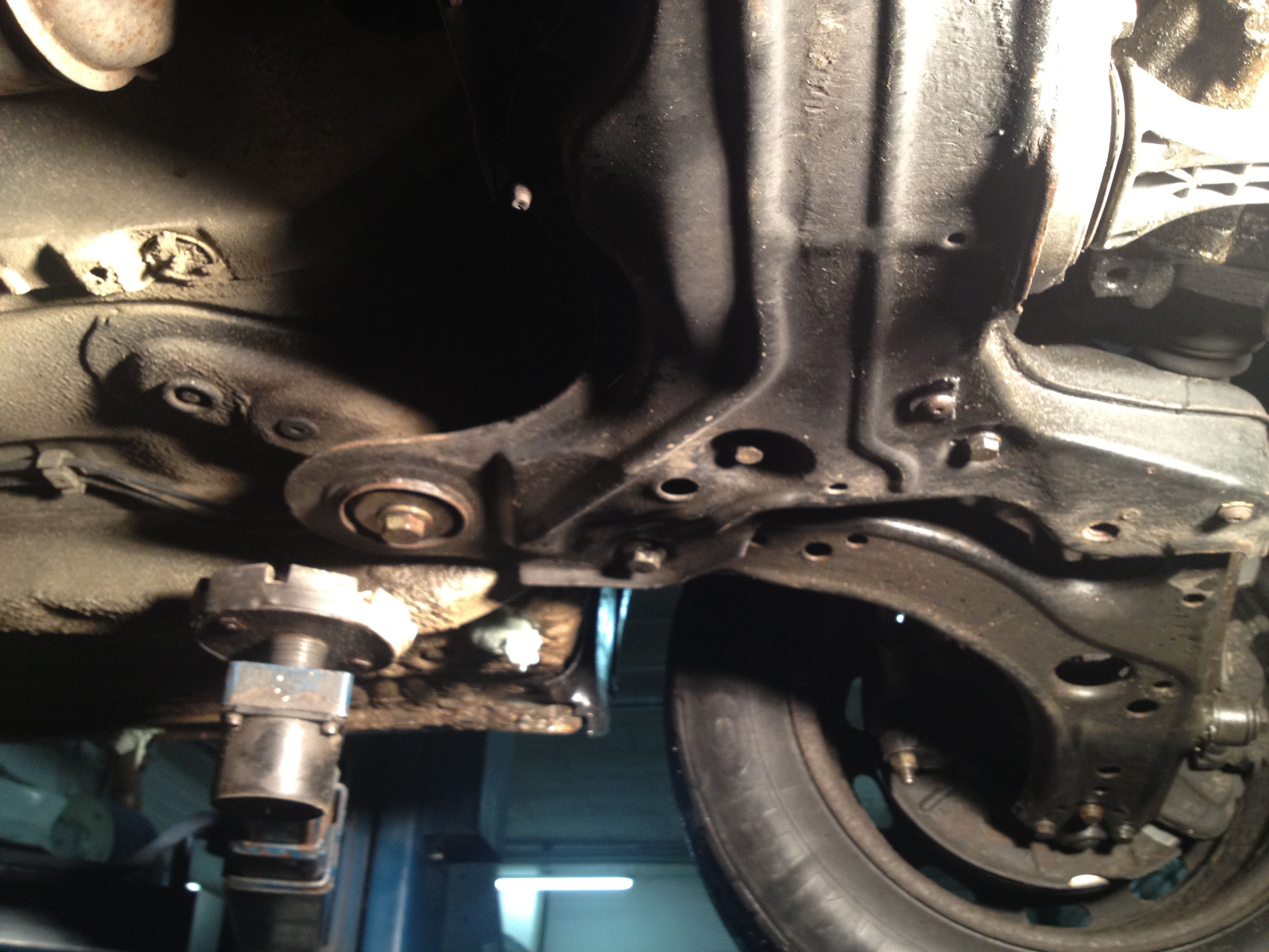

I am referring to this warehouse:
/download.php?id=5528
It also consists of two halves - an upper and a lower one.
Can they be replaced if the central screw is out, or are they really pressed in?

Post20-11-2012, 14:04    Subject: Torque hum at AHF / BLS Quote
Finally got him on stage yesterday, looks completely different than in the Toledo...
Now, I suspect that the problem is more likely due to the drive shaft bearings, as both show significant play. Exchange will bring clarity icon_smile.gif

Post20-11-2012, 14:42    Subject: Torque hum at AHF / BLS Quote
Yeah, this is the Golf IV version of the shock absorber.
