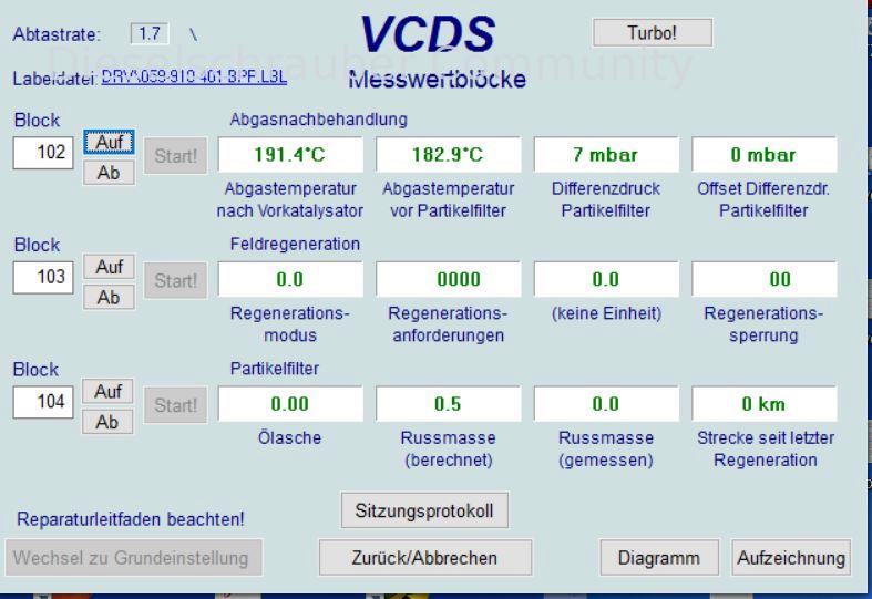

Hello everyone,
I have an A6 2.7 TDI BPP with 270,000 km. After cleaning the DPF, I want to reset the ash value to approximately 20,000 km, as I normally do with 2.0TDIs. But unfortunately, I can't find any channels for that.
Hadn't found anything through the search either.
Does anyone have an idea how it works with a 6-cylinder engine?
Thank you!

What does your engine control unit (ECU) display on the adjustment channels? (Please upload a Screenshot here)

Post17-09-2015, 7:59    Subject: BPP DPF Cleaning Quote
@dieselschrauberViewing profile: dieselschrauber
I found the post after my thread, but the channels are not available for the 6-cylinder engine.
There's only the A08, as written by Autoservice. However, you can't enter values with it. And since he only accounts for the ash after the KM, I never get a reasonable value, do I?
I reset it yesterday and after 10 minutes of driving, I measured a calculated soot value of 0.5. It hadn't produced any yet. In the LL, there is also a maximum pressure loss of 7 mbar, but it sometimes also drops to 0.
Also, it's also strange that the distance hasn't increased since the last regeneration. (The Screenshot was taken after approximately 8km of distance)
Can we still make any adjustments or should we leave it as is? I doubt I'll be able to get all the ashes out...

Post19-09-2015, 21:56    Subject: BPP DPF Cleaning Quote
The route will only be measured in 10km increments.
