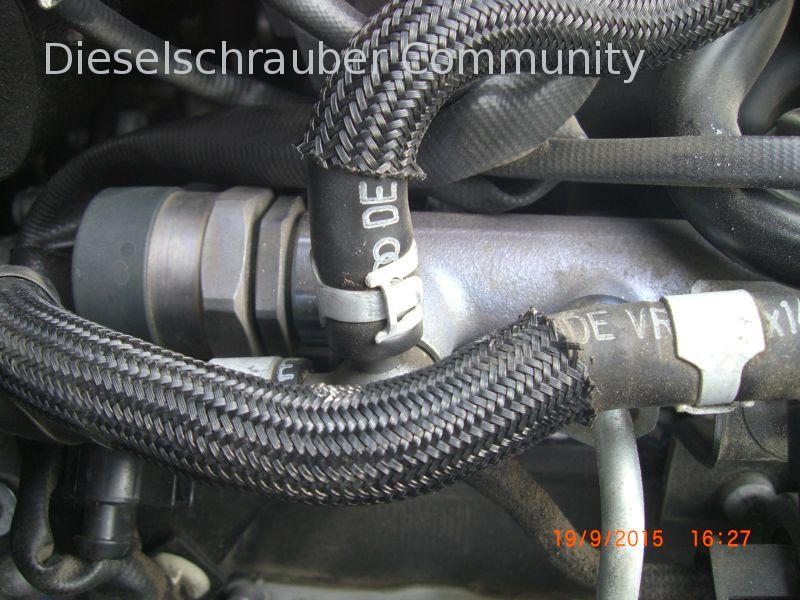

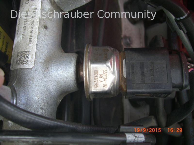

Post19-09-2015, 16:14    Subject: A6 3.0 TDI Commonrail: Low fuel pressure Quote
Hello, and thank you very much for your help.
I once took a picture of the two components connected to the overhead line.
The first image shows the right-hand rail with an actuator at the end of the rail. The visible tubes are return lines.
The second image shows the left rail, where nothing else is attached except for what appears to be a temperature sensor. Additionally, there is a pressure line connected to the other rail. Both rails have their own connection to the pump.
I think that the part on the right rail is the control valve. Is this a Bosch part?

Posts: 18128
Post19-09-2015, 16:29    Subject: A6 3.0 TDI Commonrail: Low fuel pressure Quote
I have named the images; they are labeled "Fuel pressure control valve N276" and "Fuel pressure sensor G247".
