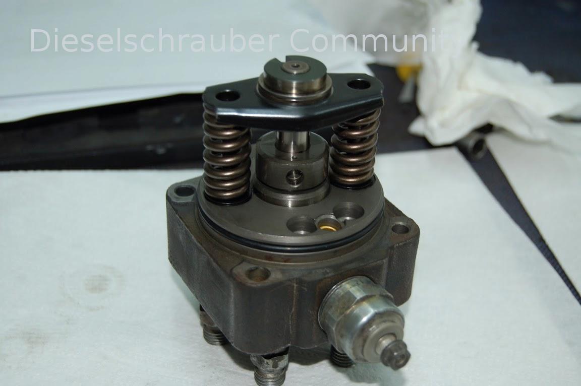

Post10-08-2015, 17:33    Subject: Warmstart 5Zyl TDI (AEL) problematic Quote
Take a look at the locking screw on the high-pressure part. Depending on the extent of the damage, you may only experience issues with warm starts, or also cold starts (valve adjustment).
I've already had several pumps with this problem.
See the image in the attachment!
Screw and O-ring number available upon request... costs around 15€;

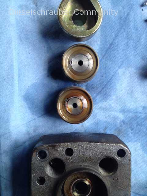

Hello VW enthusiast.
Can I please ask you about this topic again; what type of screw is it and how can I identify any damage? Although I have already disassembled pumps to completely seal them, I haven't worked on the high-pressure part, and I also didn't know that something might be defective there.
I have reassembled the part exactly as shown in the picture (with the new O-ring).
Thank you.

Post01-09-2015, 12:27    Subject: Warmstart 5Zyl TDI (AEL) problematic Quote
This is the three-pronged locking screw between the high-pressure outlets. If this has broken, then you have a leak between the high-pressure and pump internal pressure. It is not noticeable from the outside, as nothing (exteriorly) leaks, but at the low starting RPM + small initial amount, the nozzle opening pressure may not be reached or only after several pumping operations.
