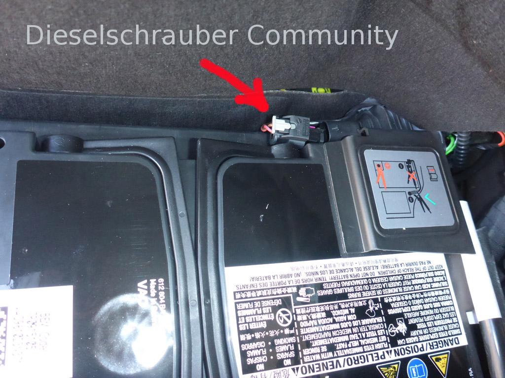

"What component/function is this connector next to the battery terminal for?"
For me, it's a Skoda Yeti from 2017, while for my acquaintance, it's a Seat Leon from 2016.
I suspect that even more models from the Volkswagen Group have this part installed.
 Plug next to battery terminals - function?

Evening.
I would argue that this is related to battery management.

If the component is connected to the pulse pole (or is part of the terminal), it is definitely the battery sensor.
Golf IV Variant 1.9 TDI
Wrong! The battery sensor is located in the main power cable.

brezelmann01 wrote:
...Wrong! The battery sensor is located in the chassis ground wire.
Sure?
We have tested both the Hella parts (12V and 24V versions) and the old ISA ASIC.
As far as I recall, they were all connected to the positive and negative terminals (for voltage measurement), and the small connector was used for that purpose.

I stumbled upon an article about the battery connector. Apparently, disconnecting the connector disables the start-stop system. This results in error messages in the instrument cluster, but so far I haven't experienced any problems. Best regards, Wolfgang.

klahaui wrote:
Evening,
also falls under battery management.
That's correct!
