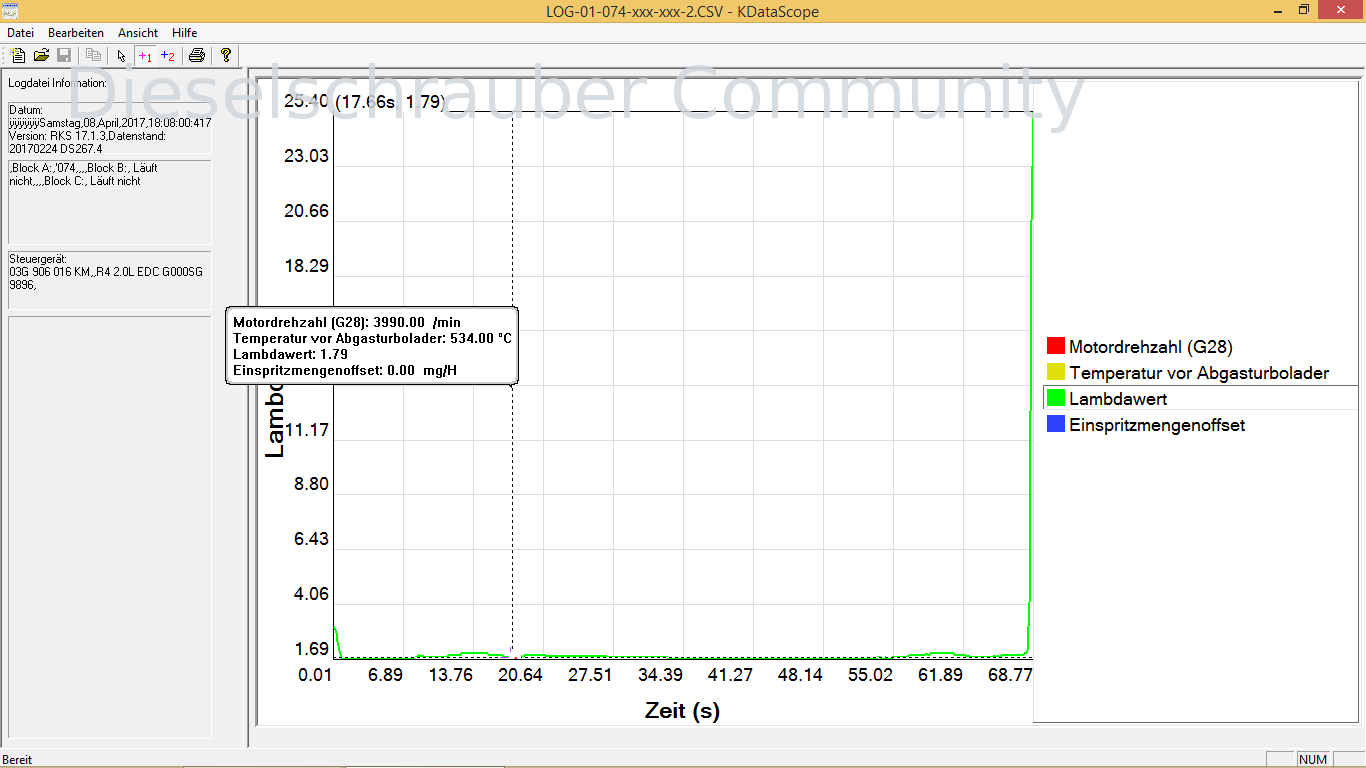

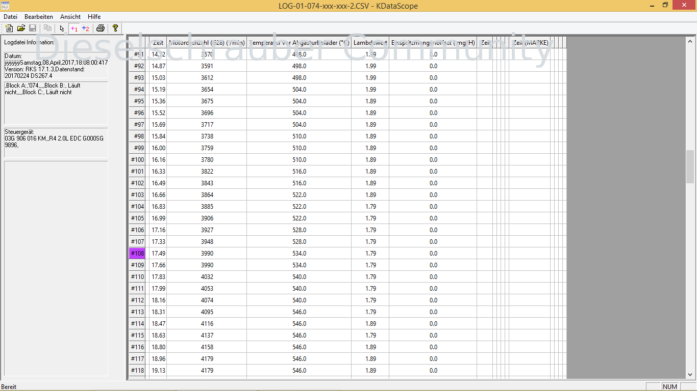

That was another piece of junk, the first half of the file was converted, but the second half wasn't. Please don't use csvconv.exe anymore; as you can see, it only produces garbage.
I manually adjusted the file, but the lambda value is too high. I was expecting values around 1.35.
Your injectors are not actually known to be prone to carbon buildup (or have modifications been made to the PD units?), so you should definitely review what has already been written.
So, diesel filters are best replaced, are the seals on the "Knackfrosch" okay? Check all fuel lines for leaks and signs of rodent damage, and make sure all hose connections are properly attached.
If there is still no performance: Measure whether the tandem pump can properly build up pressure.
With KDataScope, life can be this simple, see the pictures.
