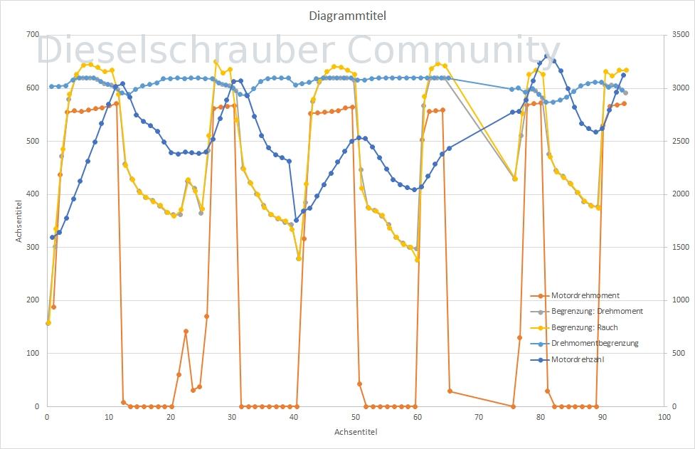

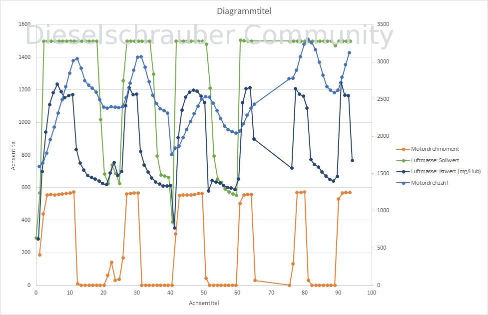

Here are two diagrams from a VCDS log recording. The mass airflow sensor never reaches its target value.
Gears 5 through 6 are engaged, and gear 6 is selected. The turbocharger pressure builds up with a delay.
Is this deviation normal? Could the mass airflow sensor be defective? Where else could I look?
DPF loaded with 0.15L, which is within the acceptable range.
Perhaps the car isn't as responsive as it should be, but I want to make sure that nothing is broken.

Okay, I can't really make out much from this... Could you please upload the raw .csv file of an acceleration process, including torque limits and speed data?
You could also simply have a power measurement performed by KPower.

I am particularly interested in understanding why the LMM target value is not being reached.

The values look normal to me, but someone else might notice something.
It might also be interesting to have a log that includes information such as engine speed, engine torque, target boost pressure, and fuel injection volume.
Have you already done the performance testing?
