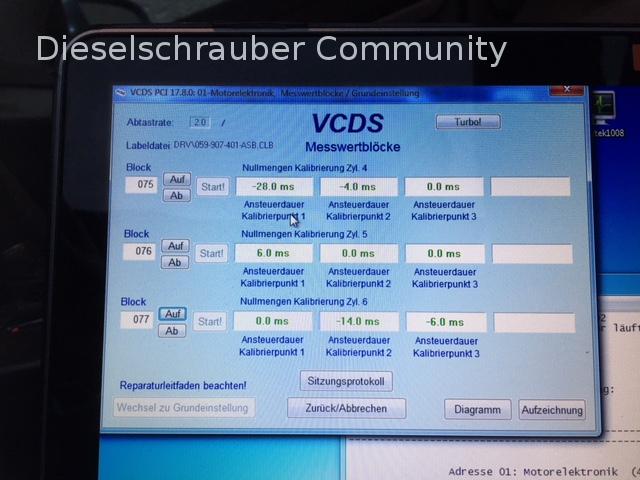

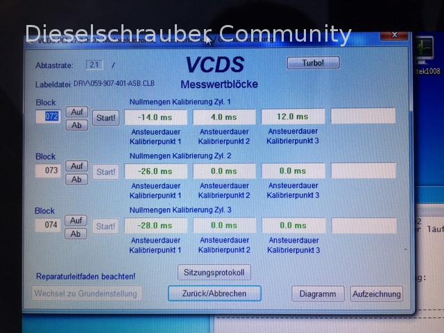

Regarding the injectors, I'd like to mention that the car had its injectors (diesel technology...) refurbished at 52,000 km. I have attached the values as a photo, and the MWB 77 value seems suspicious to me.
Steering Calibration Point 1: 0.0ms
Steering Calibration Point 2: -14.0ms
Steering Calibration Point 2: -6.0ms
Is it normal for values to be at that level with revised injectors after a certain amount of mileage?
It would be great if you could give me some tips.

Regarding the values of the injectors:
After 52,000 km, this is not normal, because negative values indicate wear, which means a leak. Unfortunately, it's not just that one injector that's suspected to be faulty.
At the lower pressure settings, it should ideally exhibit slight idle fluctuations due to post-injection. That explains the smell.
Which parts were installed? The BMK (likely referring to a specific engine or component) was very susceptible to issues, which is why the injectors were changed starting in model year '07. The ones from ASB, with 233 horsepower, would be more stable.

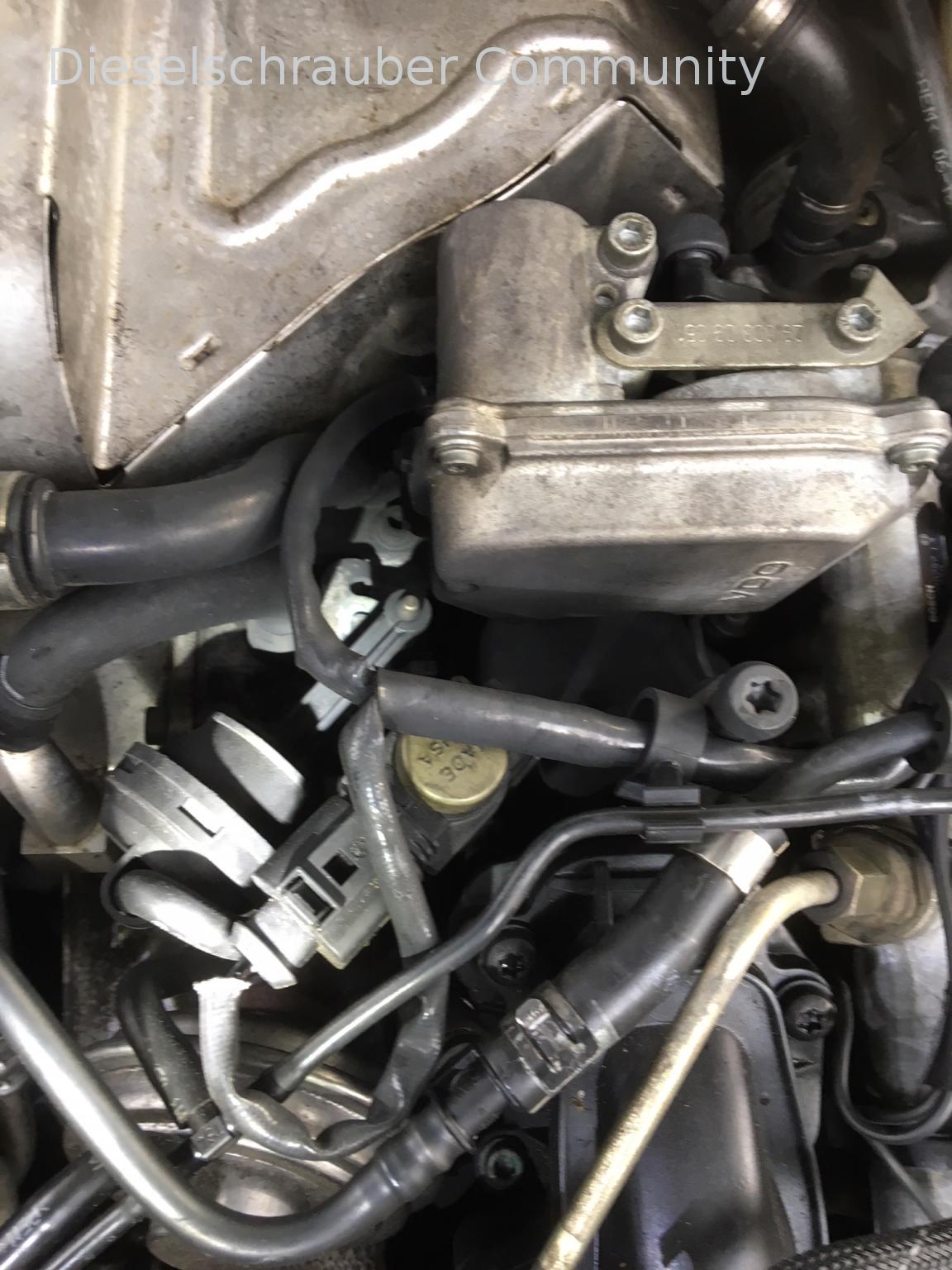

The exhaust smell is a common issue with the first-generation CR-V6 diesel engines. The issue is usually caused by a worn-out housing for the AGR valve conversion.
Remove the engine cover. Just to the left of the turbocharger, there's a small black vacuum canister that controls the valve.
The valve housing directs exhaust gases and coolant, but exhaust gases escape from the defective bearing of the shaft.
Usually, everything around it is quite sooty; just take a deep breath near it after a cold start, and you'll immediately smell it icon_wink.gif.
Unfortunately, the storage compartment cannot be swapped out because the flap inside is welded to the shaft, making it impossible to disassemble.
The new one is 059 131 063 D and costs approximately 130€.
Regards, Mpire.

Thank you for your feedback and information... I'll need to take a look at the AGR cooler tomorrow in daylight. It makes sense, anyway. icon_smile.gif
Regarding the injectors, I thought about it, but I didn't expect the injectors to "wear out" so quickly again.
According to the wear limits (first value -45, second value -15), they don't need to be replaced yet, right?
What could have caused the premature wear? They were installed last December and haven't been driven for that much, only 50,000 km. It probably doesn't speak very highly of the quality...

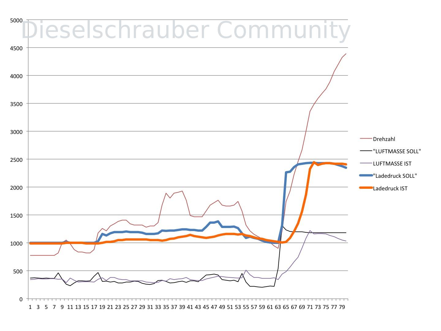

Perhaps someone can give me some more information about the log values for icon_biggrin.gif Turbo and Mass Air Flow Sensor (MAF).
"Thank you very much..."

Thanks for your feedback and explanation. The DPF is probably going to fail eventually anyway. I'll get started on the work next weekend. It looks quite "dusty" around the enclosure.
What is the best way to replace the valve? Does the entire AGR cooler need to be removed, or can the work (e.g., swirl flaps, cover, EGR valve) be done while it's still installed?

PS: What do you think about the turbo and mass airflow sensor values? When I look at them, they don't seem quite right. The turbo has quite a few miles on it now, approximately 370,000 km.
