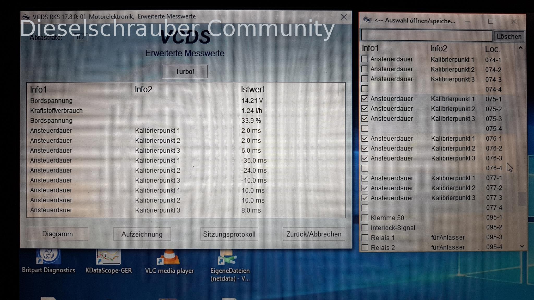

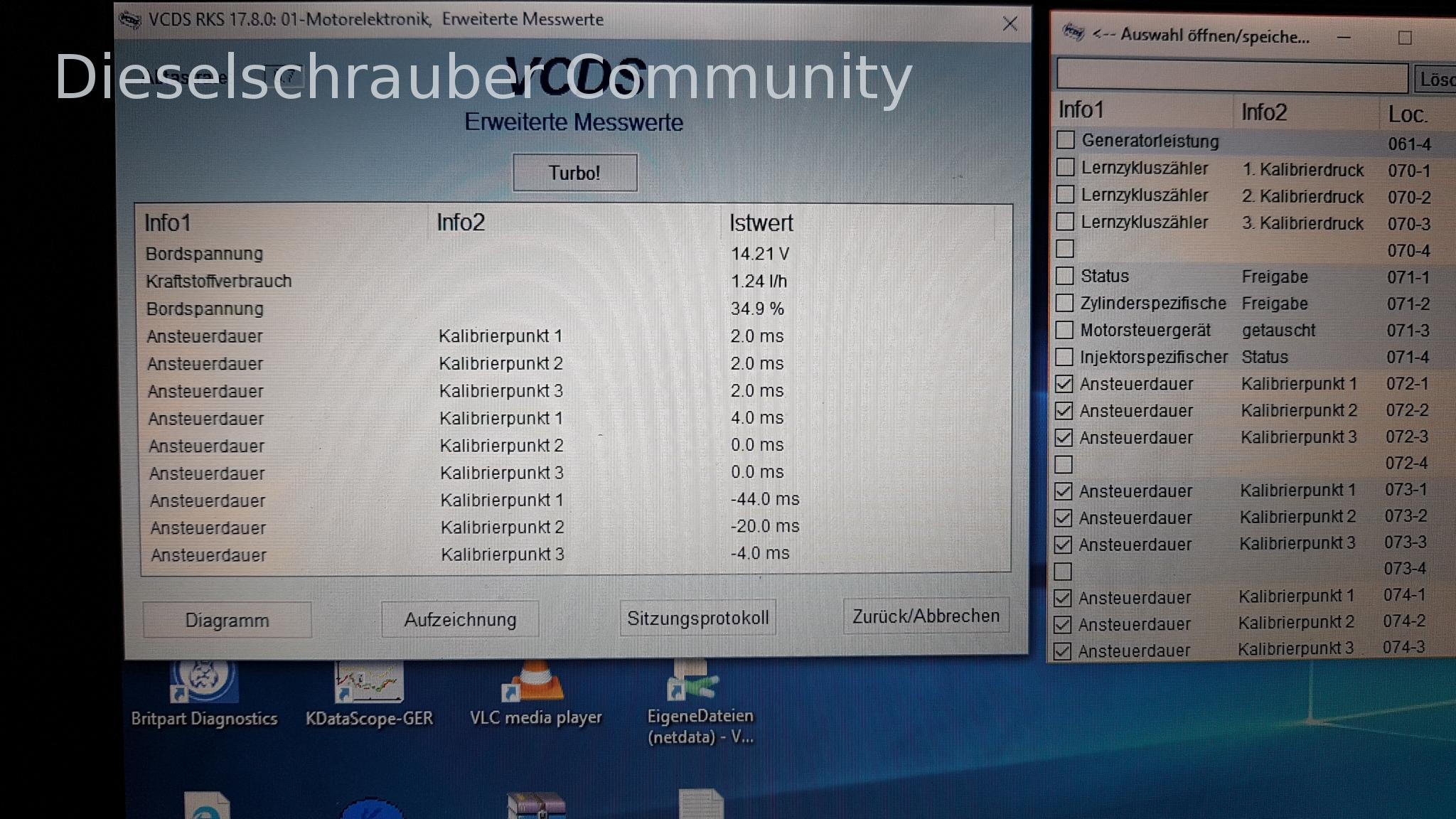

Hello everyone,
I have a 2006 Touareg with a 3.0 TDI BKS engine and 112,000 km. Occasionally, after being parked and after a short period of inactivity, it doesn't start immediately (the starter motor can't turn the engine over and shuts off). Since the battery, cables, etc. seem to be fine, I've now read the VCDS values for the fuel injectors. It seems like injectors 3 and 5 are failing (they are dripping fuel and causing the problem described above) and need to be replaced.
Nozzle 3: KP1: -44ms; KP2: -20ms; KP3: -4ms.
Nozzle 5: KP1: -36ms; KP2: -24ms; KP3: -10ms.
All other nozzle K-values are in the 0 or positive range.
Can someone please confirm my assessment (files attached)? I don't want to change two nozzles if it's not absolutely necessary.
Thank you.
Uwe.

The values are quite noticeable, see:
"Mileage tampered with? 116,000 km isn't that much... But could that be why the starter isn't working? I find that hard to believe; if that were the case, there would have to be significant fuel leakage, and the engine would start with a lot of hesitation and smoke..."
Translated on 30-08-2026, 2:44.

So, the two injectors are definitely faulty and are leaking.
This "phenomenon" of the brief stalling is also a clear indication of significant fuel leakage during the night. It's a typical sign in V6-CR-TDI engines and is well-known as an indicator of faulty injectors.
The combustion chamber fills with fuel, and this fuel cannot be compressed.
The compression ratio increases due to the lack of combustion chamber space, and the starter motor cannot overcome the increased resistance.
The starter is not "at fault" there  .
The reason you don't see any smoke after starting the engine is likely due to the particulate filter.
Replace both of them with new ones (Bosch, from Austria; forget about those cheap, refurbished parts, they don't last long).
Adjusted the code, and it's working again.
Regards, Mpire.
