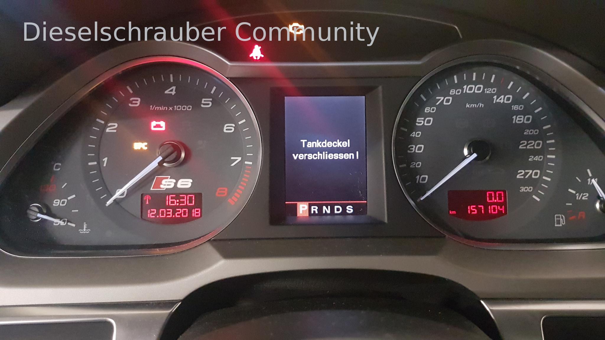

Hey everyone,
"For some time now, I've been having a strange issue with an Audi S6 Avant 5.2 FSI in the workshop: the message "Tankdeckel Verschliessen" (which translates to "Fuel Tank Lid Closed") is appearing on the instrument cluster display. I've connected VCDS to read the error codes, but I haven't found any. I've also tested the individual control units separately, but still no errors. Does anyone have any ideas, or is something that needs to be programmed?" The fuel tank cap was also replaced, but without success.

Thank you for the quick response. No, the fuel tank lid only has a servo motor with two wires (green/violet and green/gray). I completely disassembled the lid and there are no sensors installed. The central locking system works perfectly; it opens and closes without any problems. There is no button installed inside the car, but the instrument panel displays this message as shown in the photo. I have also checked the "Comfort" settings (code 46) bit by bit, and I haven't found any errors. I also tried using the coding assistant to enable and disable the "fuel tank lid open" function (even though, as I said, there is no button inside), but without success. I'm almost certain that there's a coding error, but I have no idea which module it's in. "The customer says he installed the LED daytime running lights himself two months ago and programmed them with VCDS, but this message has appeared for about two weeks."

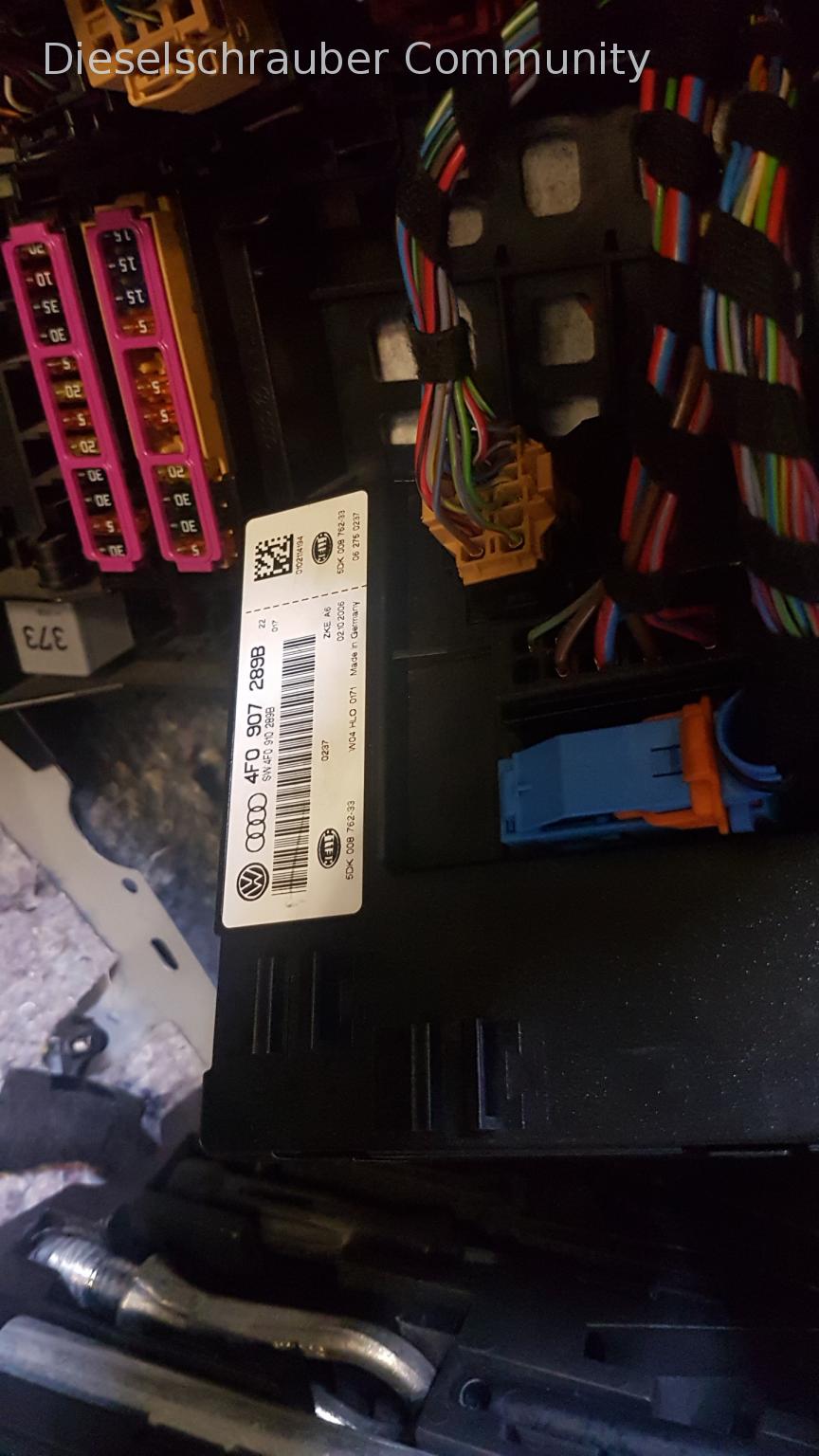

Does anyone have a schematic diagram for this control board? (see photo).
The idea is to check where the fuel tank cap sensor is connected and potentially short-circuit the pin to help diagnose the problem.
Thank you all again.
