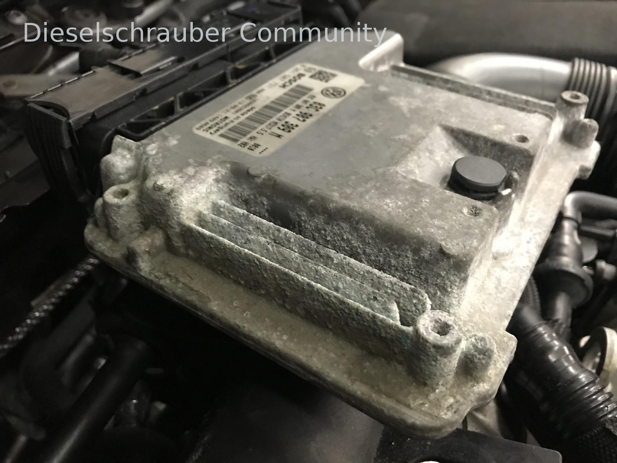

Post20-11-2018, 1:20    Subject: Replace motor control unit VW Passat B7, year of manufacture 2014, 1.4 TSI, 118kW Quote
Hello everyone.
First of all, thank you very much for the already very helpful answers you have provided.
I wanted to copy a diagnostic report today and post it online for you.
I drove around for 2 hours, going uphill and downhill, sometimes pushing the car hard and sometimes driving gently... but to my absolute astonishment, the problem didn't occur again.
I'm not sure if this could be related to the outside temperature, because today it was -0.5°C here, but on Saturday when I received the car, the error appeared immediately after a short test drive (outside temperature of approximately 2.5°C).
I have to admit that on Sunday, I moved and tested every inch of the cable harness from the engine control unit to the ignition coils in every conceivable way. I even removed the engine control unit and visually inspected the pins... but I couldn't find any results. Everything looked perfect, and the cables, as far as I can tell, don't have any breaks. The only thing that looks a bit worse is the housing of the control unit... (it's oxidized).
Okay, I'm not really sure what to make of all of this. I'll drive to work tomorrow, which is about 100 kilometers round trip, including highway driving. Let's see what happens.
