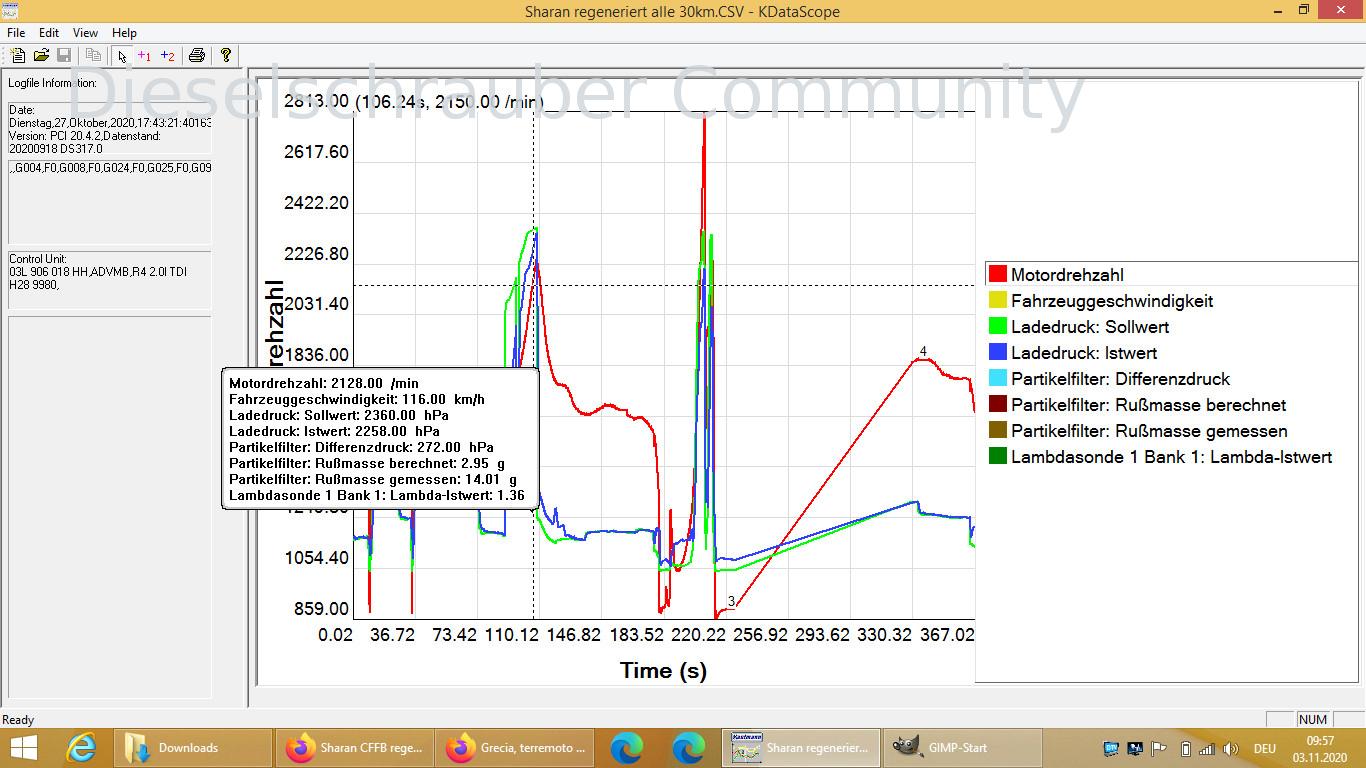

Post03-11-2020, 10:04    Subject: Sharan DPF: Regenerates Every 30km Quote
Ash on my head, I only viewed the differential pressure as a text file on my phone, and either didn't scroll down far enough or opened the wrong file.
With KDataScope, you can clearly see the peaks in the differential pressure that significantly exceed the comparison values.
 Differenzdruck in KDataScope.
 File size:  245.33 KB
 Viewed:  1229 times
Translated on 02-10-2026, 5:47.
