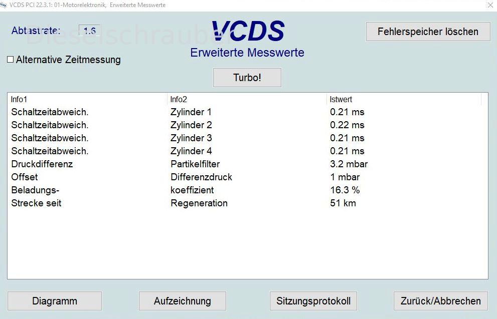

Update:
I installed a new differential pressure sensor from Bosch and cleaned the hoses with compressed air.
I used VCDS to initialize the new differential pressure sensor, and now I'll see when it regenerates next.
When idling, the new sensor shows a differential pressure of between 3.2 and 3.7 mbar. It fluctuates constantly.
The offset pressure remained constant at 1 mbar, and it stayed constant at 1 mbar even during movement.
What exactly is offset printing, and is a constant value of 1 mbar a good thing?
I've noticed that the switching deviations of the PD elements have improved significantly after replacing the differential pressure sensor.
I've attached a picture for you.

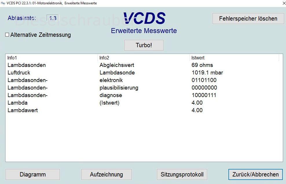

Post21-08-2022, 9:22    Subject: DPF Regeneration: Frequent Intervals Explained Quote
Okay, I used VCDS to read the lambda values while the engine was idling.
Did I check the values correctly, and are they correct?
I've re-performed the basic adjustment for the AGR (Abgasrückführung) system, and the AGR values are within the specified range when the system is active and inactive.
