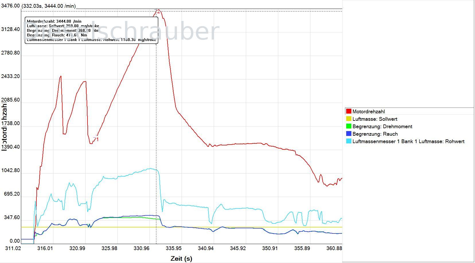

After the vehicle change (from Sharan CFFB to Sharan DFLA), the DPF regenerations occur approximately twice as often (about every 100 km). The driving profile has remained the same (short trips in the city), but the CFFB regenerated every 250-300 km. Is there a good way to systematically investigate whether something is wrong?
Vehicle specifications: Mileage approximately 98,000 km, turbocharger boost pressure normal during test drive, DPF oil ash mass 30.2 g (loading limit 80 g), differential pressure sensor reading 0 hPa when ignition is turned on and the engine is off.
Jetzt habe ich noch für LMM Logfahrt gemacht, die Ergebnisse hier. Ist da was auffällig? Was ich noch bemerkt habe, dass die Lufttemperaturen, die LMM liefert, schwenken von -50 bis ca. 100 Grad (besonders beim Start/Stopp ein, wenn Motor aus gibt er -50 Grad, wenn Motor startet, dauert es ca. 10-20 s bis der Wert realistisch wird). Is that normal?
Thank you in advance for your suggestions.
