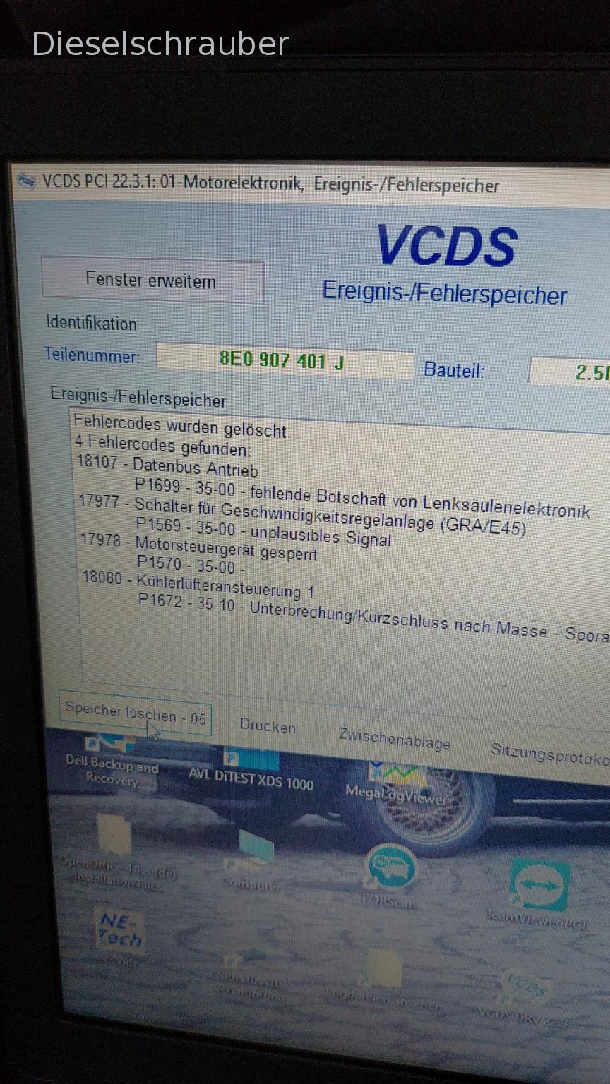

I have calibrated the pump, but nothing has changed. Could it be that my engine control unit (ECU) is possibly defective? Are there any people in this forum who can check that? Here is my current error log.

Post27-12-2022, 16:54    Subject: Audi A6 Vp44 issues after pump replacement Quote
Hi.
Perhaps we can fix the existing errors as much as possible.
