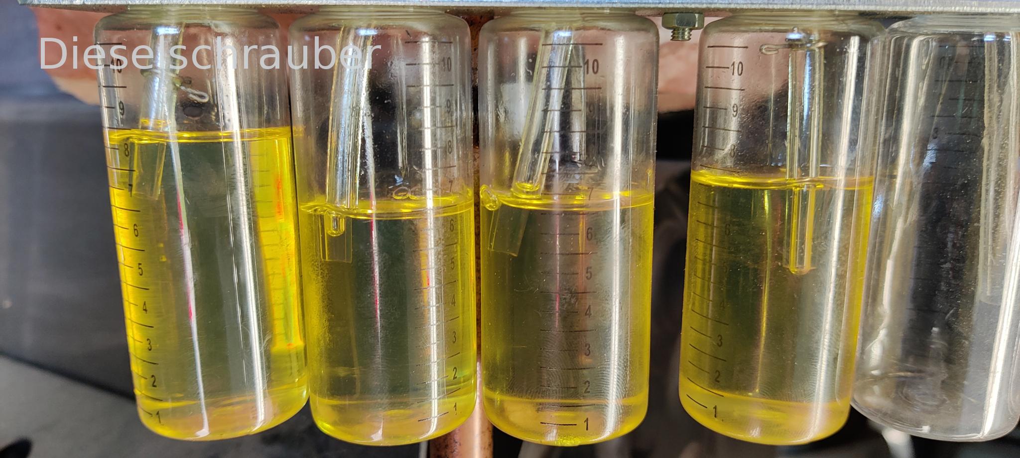

It's noticeable that the amount of oil leaking from the injectors varies among the four injectors. The cylinder with the largest leakage is cylinder 1, which is the most significant outlier.
Here's another picture of the measurement (from left to right, the cylinders are arranged from left to right when you're standing in front of the car). The measurement ran for approximately 6 minutes, 5 of which were at idle, and 1 minute at the rev-limited speed while stationary (so around 2500 RPM or something).
As far as I can tell, there's likely a leak inside the injector, probably into the combustion chamber.
When the engine is warm, any leakage from the injectors stops.
Are there permissible leakage amounts? Are all 4 injectors showing unusual behavior?

I would check the injector timing.
Comparison values may be found here.
Okay, I understand. Please provide the German text you want me to translate into English. I will only provide the translation.
Then, consider the control behavior of the EGR (Exhaust Gas Recirculation) system and the fuel rail pressure. For both, you have a target value and an actual value. If the control behavior is erratic or if there are persistent differences between the target and actual values, I would investigate the EGR valve or the fuel rail pressure control valve more closely.
"Cold start" (even at a minimum of 16 degrees Celsius at night), it jerks, misfires, and the throttle response is poor.
If the above checks are normal, there is still a possibility that the engine control unit (ECU) is experiencing power supply issues.
In this case, I would use VCDS to log the above data during a cold start.
If you're experiencing "stuttering" or unexplained interruptions and pauses, I would investigate the power supply area, specifically the engine control unit and, in general, the entire wiring harness (looking for damage or chafing).
Generally, it's a good idea to carefully inspect the wiring harness and check the connections at the relevant sensors.

There were problems with the high-pressure pumps in the engines.
What is the pressure rating of the high-pressure pump?
Index K has announced the imminent "end" of its operations, citing the problems you described.
Have you ever checked the amount of material returned by the magnetic separator to see if it's mostly chips?
If you can rule that out, you can continue using the injectors. The return flow should be approximately the same.
Perhaps you can still save the nozzles with a fuel injector cleaning treatment.

Okay, as far as I can see, the pump has the "H" designation. I should be able to check the metal part in the filter tomorrow; I've kept it aside.
I can't find the injector timing values in the measured data, and it's also not clearly indicated whether the data relates to the EGR valve or the fuel rail pressure valve. Is there a specific name or IDE number for that?
Regarding the pressure and rail pressure control valve, isn't it strange that the symptoms disappear when the engine is warm?
Thank you very much!
