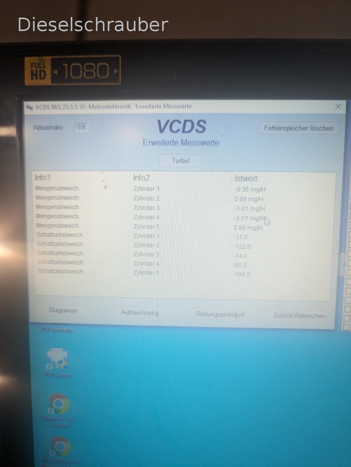

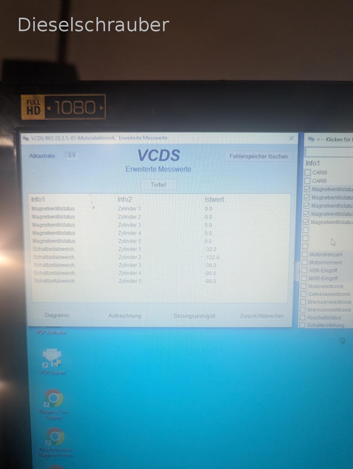

Good evening, everyone.
Here's a problem I'm having with my Touareg.
The engine was replaced a few months ago, but I unfortunately don't know where or by whom.
Idling is very unstable. Okay at 1400 RPM.
Starts immediately without any problems.
No errors found.
BAC Motor 2.5 TDI 2005.
Here are the values for vcds.
Two power drive elements (PDEs) were recently replaced, specifically cylinders 2 and 5.

Shouldn't the high variations in switching times indicate a fuel shortage? I seem to recall reading something about that; do you know anything about it?

Kevgo24 wrote: | I had removed all the PD elements and resealed them, as I had encountered a similar issue before. |
Kevgo24 wrote: | | Shouldn't the high switching time variations indicate a lack of fuel? I read something about that once, do you know anything about it? |
Good question, there's no unit attached, I suspect it's US.
Sorry, I don't have any specific values in mind right now, but comparison values should be available in various threads within this forum.

It just makes me curious that the values are changing to zero. Cylinder 1, for example, has even better values after the diesel filter change and is at 0.
