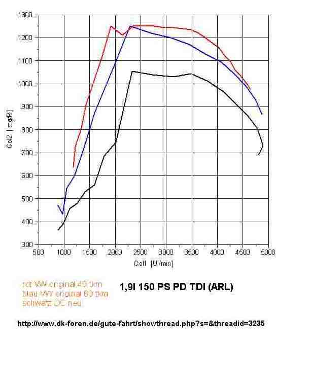

ulf Profi-Schrauber
Joined: 04/13/2002 Posts: 11058 Karma: +18 / -0 Location: Saarland 2023 MG ZS Premium Support
11-07-2003, 10:00 Subject: LLM from DC: A Problem Solver for All Walks of Life? |
Quote |
WarLord wrote: | | According to what I have read so far, the LMM (Mass Air Flow sensor) works without problems on 1.9 TDI engines, and according to VAG Com, it shows the same values as the original LMM from VW/Bosch. However, it is said not to work with the 2.5 TDI engine. |
Hi.
I once copied a picture from another forum.
The comparison (using VAGCOM data logging) refers to a 150 hp TDI engine, which already has the highest airflow rate of all (standard) 1.9 engines and is therefore most similar to the DC donor engine.
| Description: |
rot = VAG LMM 40Tkm
blau = VAG LMM 80Tkm
schwarz = DC LMM |

Manuel Thomas Guest
11-07-2003, 10:05 Subject: LLM from DC: A Problem Solver for All Walks of Life? |
Quote |
@ Ulf, nice graphic!
The only thing that bothers me is that it's from the 'Gute Fahrt' forum! Sometimes I get the feeling that VW employees are posting there and sabotaging all the good ideas!
In the Passat3b.de forum, a similar measurement was performed, but with the result showing less air mass being measured up to 2000 RPM, and then a slightly increased air mass reading afterwards.

felix Blaumann
Joined: 07/01/2002 Posts: 57 Karma: +6 / -0 Location: Scharbeutz/Ostsee
11-07-2003, 11:48 Subject: LLM from DC: A Problem Solver for All Walks of Life? |
Quote |
@Manuel Thomas
Don't worry, this post is from me; I originally posted it on vw-audi-forum.de.
posted, and I am not affiliated with Volkswagen.
My car ran significantly worse with the DC-LMM than it did with the original one.
Below approximately 2000 RPM, there is very little power output, but then there's a sudden surge of power that occurs because, from that point on, the power output becomes relatively normal.
Gruß Felix
