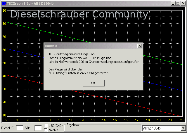

How do you properly check the timing? When I test it at idle, my values are slightly below the lower limit. And when I give it some throttle, they drop even further!

Do not accelerate. The default settings mode must be enabled (I'm not sure if the timing checker also works in a non-default settings mode, and it's extremely cold outside).
Otherwise:
 TDI Spritzbeginneinstellung mit TDI-Graph
