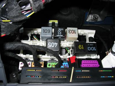

Post24-05-2004, 16:13    Subject: Where is relay 109 in an Audi A4? Quote
You need to check the central electrical panel, usually located on the left side, underneath the dashboard - that's where you'll find things like the windshield washer relay, etc.
Here's an (old) picture of my Ibiza. The Relais 19 has since been replaced by a Relais 99 (a more comfortable wiper system).
Best regards,
Jan.
 Relaiskasten im Ibiza MJ 2002
 File size:  31.53 KB
 Viewed:  28580 times
1Z5 CFHF / AHB H4D
PrivatBereich
Guest
Post24-05-2004, 16:16    Subject: Where is relay 109 in an Audi A4? Quote
I'm not entirely sure how it looks on an Audi, it might have a different part number.
To figure it out yourself:
Take a look at the wiring diagram to see which relay can maintain the voltage supply from the battery positive terminal to the engine control unit even after the ignition is switched off.
This is the relay, which is commonly referred to as 'Relay 109' within this forum.
Regards,
Private.
