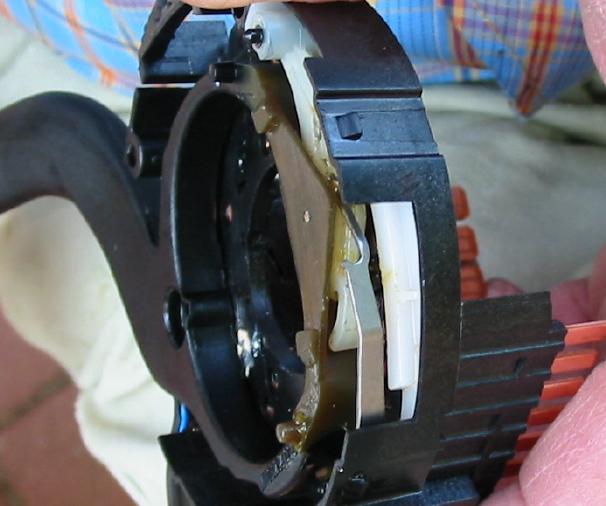

Post06-06-2004, 20:53    Subject: Blinker Switch: Mechanical Design and Disassembly Quote
I tackled the whole thing today and managed to disassemble it quite easily (dealing with the airbag isn't nearly as bad as you might think - I would still advise only attempting it if you know exactly what you're doing).
I also took some photos, but I'll do that later (and not while removing the airbag) because I currently have very little time.
The problem was the following:
Inside the turn signal switch, there is a spring with a forked end that rests on a plastic piece and is held in place by the fork. This defines the position of the spring and prevents it from slipping out.
"On my unit, a 'tooth' on this fork had broken off, causing the spring to shift backward and become slightly jammed. This positioned it closer to its mounting point, giving it more force, and also caused it to act on a longer lever. The result was a significantly higher counter-force at the end, with no counter-force in the middle, which explains the behavior described above."
"Since this spring is irreparable, I used a temporary fix (because I need the car) by laterally tensioning the entire assembly. This way, the intact leaf now sits in the track of the broken one, and the lateral tension prevents it from slipping. I ground down the remaining piece of the broken leaf so that the slightly angled spring doesn't rub, and that's it – it works perfectly, and I've saved a lot of money for now."
It obviously can't stay like that for long, because that one prong won't last forever, and it's probably wearing down the plastic part much more than it would normally. But at least now I have time to look for a replacement part.

After picking up my girlfriend this morning, here's the promised addition. It's just a photo, but you can see the forked feather, which is missing a barb.
In the photo, it's already in the "new" position, meaning it's so tightly wedged that the tine is running in the groove of the other part. After taking the photo, I ground down the tine fragment further to prevent any rubbing against the upper part.
