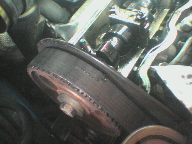

I have a Passat manufactured in November 1993 with a 1Z engine.
He has already driven 266,000 kilometers.
Attached should be a picture of the timing belt. Two main tendons have already ruptured.
And that's after 80,000 km and 30 months.
I nearly had a heart attack when I saw that.
I highly doubt this belt would last another 10,000 kilometers.
The last oil change was done at a VW workshop by the previous owner.
These are also genuine VW parts.
The previous owner drove it for 10,000 kilometers.
I drove the other 70,000 km in 12 months. 99% of that was on highways.
I replaced the belt, including the tensioner pulley and idler pulley. I also replaced the crankshaft pulley bolt, even though a 12.9 grade bolt was already installed. It was also quite firm, perhaps too firm for my taste.
I also replaced the serpentine belt and the V-belt at the same time.
Now I would like to know how that can happen.
I checked all possible values using VAG-Com after the replacement, but everything seems to be fine.
Both the crankshaft and the camshaft can be turned normally.
Are the daily 260 kilometers of highway driving an unusually high load on the timing belt?
I can't really imagine that, since I have a speed limiter and usually drive at 140 km/h.
I hope someone here has an idea about this.

Post01-08-2005, 21:35    Subject: Timing belt condition after 80,000 km + 30 months, how is this possible? Quote
It could also be a pre-existing damage to the wheel rim, caused by, for example, prying it off the hub with a screwdriver, which is now becoming noticeable.

Post02-08-2005, 9:29    Subject: Timing belt condition after 80,000 km + 30 months, how is this possible? Quote
...or perhaps the previous owner drove it more than 10,000 km. Could it be?

Post02-08-2005, 12:19    Subject: Timing belt condition after 80,000 km + 30 months, how is this possible? Quote
It looks like a stone might have been lodged in your turbocharger.
Take a closer look at the abrasion on the lower ZR cover. Besides the red rust, there's usually some sandy material in there. That's residue from stones. They cause lasting (but not immediate) damage to the ZR.
If a ZR cover is missing or has gaps, the risk of foreign objects entering is even greater. It is often overlooked.
m.w.

Post02-08-2005, 12:20    Subject: Timing belt Quote
Thinking back to my old CS 50PS diesel days: Volkswagen's official timing belt replacement interval was 80,000 km, but the "internal" recommendation was every 50,000 km.
Audi has also significantly reduced the recommended service intervals in the past.
While my belts have never looked like that, I do regularly check them (including the side edges, etc.).
I can imagine that the belt might have been slightly damaged at some point, similar to a "curb rash" on a tire, and then gradually lost its functionality.

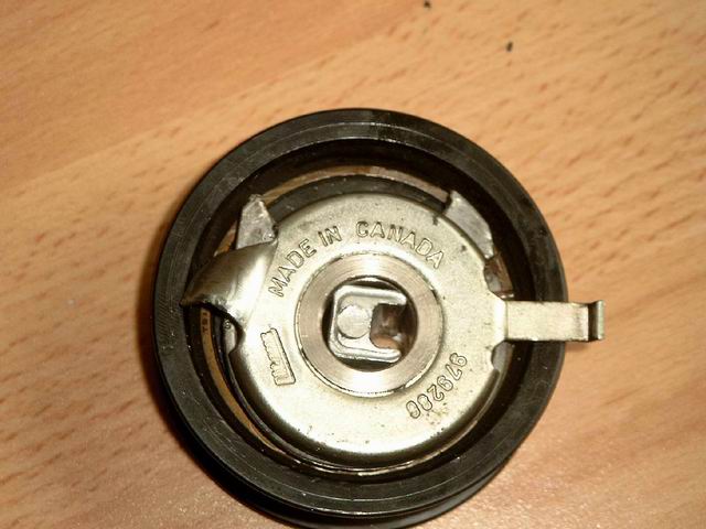

Post02-08-2005, 13:02    Subject: Tension spring Quote
oho, I still had an issue with the tensioner pulley during Easter; somehow, a metal sleeve got into the belt drive (after a motor change by a company that also "just happened" to disable the pressure line from the turbo with a screw icon_evil.gif?).
"Of course, I replaced the belt (and briefly opened the valve cover..), but there was no visible sign of any problem."
Hi Marcus,

Post02-08-2005, 20:50    Subject: Timing belt condition after 80,000 km + 30 months, how is this possible? Quote
I don't believe the previous owner drove that many kilometers.
The car was always maintained at a VW factory service center.
And even after the change, there were still outstanding invoices.
It still has the original turbocharger and the original ESP (Electronic Stability Program).
The previous owner had it for over nine years, and I received a lot of bills and other documents. He kept everything neatly organized.
A total of 9127 kilometers are missing from the odometer. It was replaced due to a defect at that mileage.
So, the car actually has about 276,000 kilometers on it.
No sand or similar abrasive material was found inside the covers.
The covers are also in perfect condition.
I suspect the problem was probably more likely due to the workshop. I've discovered some 'clumsy mistakes' or 'minor errors.'
I'm not used to that kind of thing from authorized workshops.
So, I think it's likely that the screw was either stripped before or was tightened with a screwdriver.
