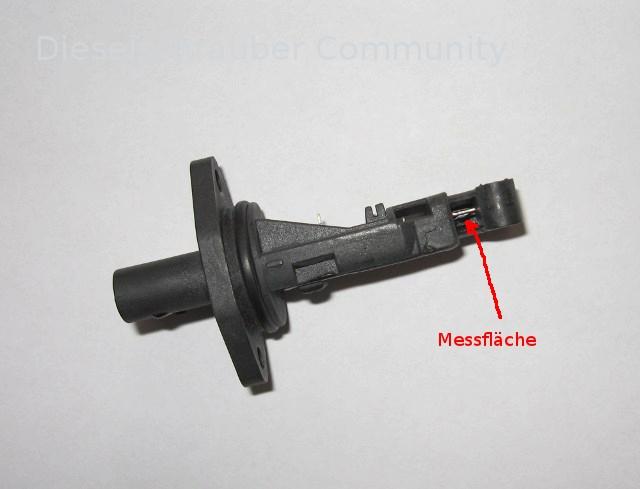

The operating principle of the hot-wire anemometer (HWA) has been further developed from earlier hot-wire mass flow meters.
TDI mass airflow sensors essentially consist of thin, temperature-sensitive sensor membranes on a small electrical "heater" in the form of a plate that is exposed to the intake air stream.
The airflow cools the sensor membrane, which in turn changes the electrical resistance value of the membrane.
This change in resistance forms the basis for generating the actual LMM signal voltage, which is achieved through integrated (analog) amplification and processing electronics within the LMM.

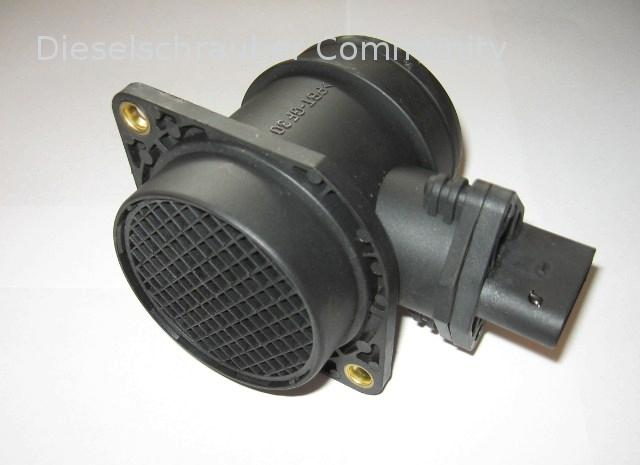

Bosch HFM 5: two-piece mass airflow sensor (housing and sensor insert), 5-pin connector with 4 used pins, analog output signal
2 = Power supply + 12 volts.
3 = Mass (sensor string).
4 = Supply + 5 Volts.
5 = LMM signal.

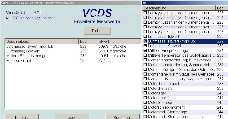

If a diagnostic system such as VCDS (VAG-COM) is available, you can directly read the corresponding measurement blocks from the engine control unit and compare whether the actual value of the measured air mass is at least equal to the target value.

To gain a deeper understanding of the causes of power loss, it is necessary to read out the injection quantity limitations, torque values, driver demand (throttle position), and air mass using VCDS or a VAG tester, with the MAF sensor connected.
If the vehicle acknowledges the diode as a replacement for the mass airflow sensor (or the deactivated EGR system) with a limp-home mode, then this testing method is the only one that can be considered.
If the actual value of the air mass measured by the air mass sensor is below the target value and exceeds 2000 rpm during full-throttle acceleration, it doesn't necessarily indicate a loss of power. In such cases, replacing the mass airflow sensor might be a waste of money.
Here, the crucial factor is the measurement data block with torque and air mass limits, as well as driver demand: As long as the opacity limit does not represent the lowest value, replacing the MAF sensor or cleaning it will not result in any performance gain, even if the actual air mass value (especially in the higher RPM range) is below the target value.
Conversely, in engines with high displacement (e.g., ARL: 150 hp / 1.9l), the full-throttle target value for air mass derived from the AGR characteristic map may be too low to raise the opacity limit via torque limitation.
However, a limitation of torque or driver demand that falls below the expected value does not necessarily have to be caused by a faulty mass airflow sensor (see above -> causes of power loss).
In some TDIs, the torque limitation is not calculated from the mass airflow sensor (MAF) value, but rather from the boost pressure. In this case, a faulty MAF sensor cannot cause a loss of power as long as there is sufficient boost pressure. If in doubt, checking measuring block 8 will indicate whether the maximum possible power is being achieved (if the torque limitation is above the actual torque).

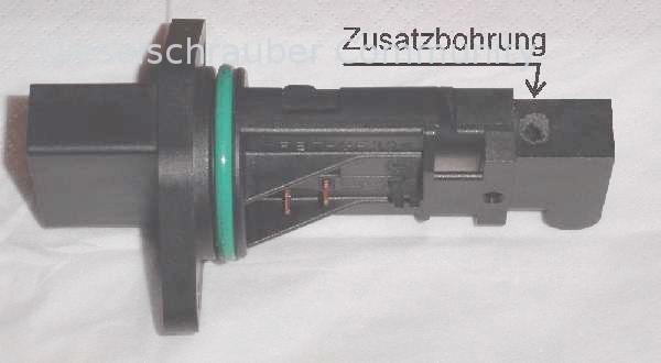

-> Using the diode described above as a replacement for the mass airflow sensor (MAF), it is possible to move the vehicle, even over longer distances ("illegally", see above), if the MAF is defective. This allows, for example, to complete a weekend trip with the usual performance. While there is no immediate risk of damage, the potentially higher soot content in the exhaust gases can, over time, make the VTG (variable turbine geometry) more difficult to operate and lead to problems with boost pressure.
If the engine control unit (ECU) goes into a failsafe mode, it may still provide more power than with a faulty mass airflow sensor (MAF), so it's worth trying in individual cases.
-> Ein alternder LMM, der (auch nach einer Reinigung) "nur" zu niedrige Werte liefert, lĂ€sst sich mit einer zusĂ€tzlichen Öffnung hinter dem SensorplĂ€ttchen zwecks Erhöhung der Luftströmung am Sensor wieder hochpĂ€ppeln, um den fĂ€lligen Ersatz hinauszuzögern (vgl. Anhang).
When drilling near the MAF sensor, work extremely carefully to ensure that the drill bit does not damage the sensing element (use a depth stop or similar)! Alternatively, the rear panel behind the air intake opening can be carefully cut out (e.g., using a saw blade held perpendicular to the airflow direction).
First, create an opening of approximately 2 mm, reinstall the mass airflow sensor (MAF), and check the effect using VAG-COM. To do this, access the AGR measurement block in the basic settings mode. When the EGR is inactive (switching between active and inactive every few seconds), the air mass value for the 1.9L engine should be between approximately 450 and 500 mg/stroke at idle.
If this area is not reached, increase the opening.

 Innenleben schlapper TDI Luftmassenmesser (HFM 5) mit Bohrung fĂŒr höhere Messwerte.
 File size:  77.7 KB
 Viewed:  355589 times
 Luftmassenmesser HFM 5, Heissfilm (SensorflĂ€che)
 File size:  36.29 KB

 Luftmassenmesser (HFM 5) eingebaut in GehĂ€use mit Schutzgitter mit Doppelfunktion der Luftberuhigung.
 File size:  45.71 KB
 Viewed:  221571 times
 PrĂŒfung der Luftmassenwerte an einem 2.0 CR 16V TDI 103kW mit VCDS. Das Diagnosesystem kann im VCDS Shop erworben werden.
 File size:  114.29 KB
 Viewed:  208310 times
