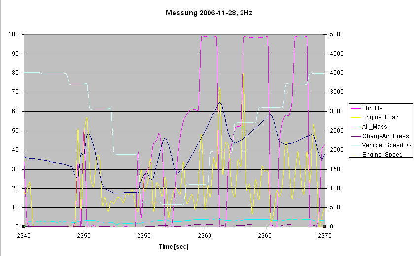

I've attached a quick-and-dirty intermediate gas pressure reading I found. (t = approximately 2255 seconds.)
The braking was not excessively hard.
Considering the level of Engine_Load (the PWM signal of the VP control), it is similar during a brief throttle lift-off as it is during subsequent acceleration.
It shows: after all, it's about icon_smile.gif
Best regards, Jochen.

Post26-04-2007, 10:14    Subject: Brake Performance and Engine Power Quote
Moment... maybe we're talking about different things... I definitely mean the scenario where the clutch is engaged, a gear is selected, the brake is applied, and the accelerator is fully pressed. You don't do that when downshifting with throttle blipping - either you've pressed the clutch or you're not in a gear, so there's no power transfer between the engine and the wheels.
Oh, yes, we will probably do that icon_redface.gif.
When you apply the brakes while in gear and simultaneously give full throttle, the load request, and therefore the fuel injection amount, is initially limited by the driver's request and the engine speed. (Fuel quantity requested = function(driver request / engine speed)).
Depending on the speed and characteristic curve, I can already request the maximum amount here.
Since the speed is unlikely to change much (or at all, as the engaged brake prevents an increase in speed), you are correct that while you can request the maximum amount, it will not correspond to the maximum possible full load amount. It will be limited by the smoke curve and the torque limiter.
If you now apply stronger braking and reduce the engine speed, the amount of fuel delivered is increasingly reduced according to torque and smoke limits. Consequently, even with 100% pedal input, the engine does not release the maximum possible amount of fuel, and it can be braked all the way to stalling using only the brake.
Actually, I don't need a brake switch to limit the amount in this case. The limits on the injection amount are sufficient for this purpose.
'Well, it's a bit complicated to describe, but I hope it was somewhat understandable.'
Actually, in this case, you are operating within fixed load points that are controlled by the engine control unit (ECU) via the injection quantities.
I hope I now understand what you meant.
