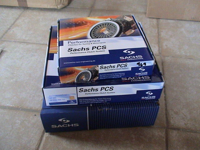

RTDI-Tom
Guest
Post28-02-2008, 19:08    Subject: Clutch Travel ARL: Explained & Troubleshooting Quote
'I can confirm this. Attached is a picture of the kit I installed, all completely from Sachs. Due to the larger turbocharger and because I don't want to unnecessarily limit the torque at 2,500 RPM, I opted for the sintered disc. With the all-wheel drive (including the Haldex performance upgrade), the question remains how long my transmission will last with this setup. Because there will be no more slip at the rear...'
