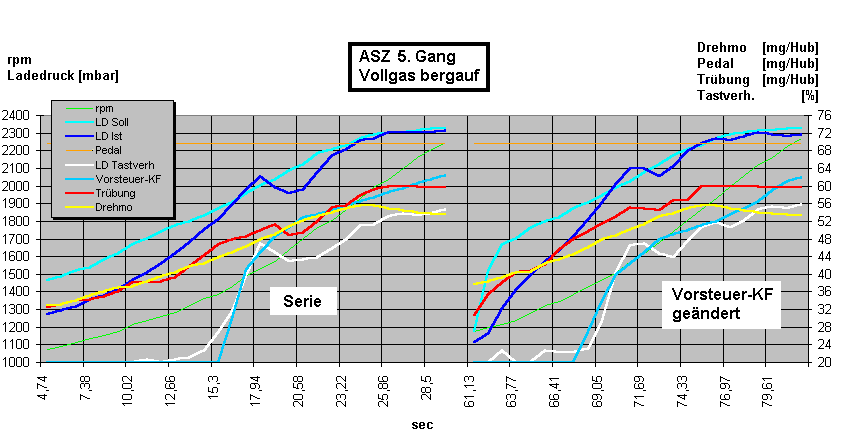

Devilseye503 wrote:
[If this is due to the learning values, then it should be possible to temporarily disable it by deleting the learning values...by resetting the main working parameter (MWB) to its default setting.]
oder sehe ich da was falsch?
Probably yes, because the default settings here have nothing to do with data deletion.
I experimented with something – see the attachment.
Considering the offset between the pre-tax CO2 emissions and the logged air-fuel ratio, it seems to me that there might already be an indication of a systematic miscalibration (at least in my car during this driving cycle).
Even if there is still a slight decrease in LDR (Loan-to-Deposit ratio), the overall result looks better with a lower offset (due to a change in the pre-tax interest rate), especially since the opacity no longer falls under the rotation speed.
I haven't been able to observe any drawbacks in other situations (e.g., excessive oversteering).

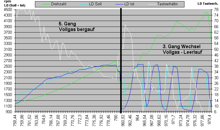

Since I don't have anything more important to do on the car right now, I tried adjusting some additional parameters of the load dump control system (P, I, and D gains, characteristic curves, etc.).
For a high time resolution, I only logged data from channel MWB 11 here.
The LD drop at 770 seconds is already significantly smaller in the initial attempt, so the distance between the onset of turbulence and the rotational speed above 1400 rpm (where the motor exits the turbulent zone) should be greater than what would be achieved with just the modified pre-injection control.
However, the dwell time fluctuates more significantly up and down compared to the standard settings, which could potentially accelerate wear on the VTG mechanism due to unnecessary movements.
If there's still room for improvement (which I suspect there is), I find myself wondering again why the LDR software is configured in such a peculiar way as shown in the diagrams above, and where the corresponding benefits lie...
The remaining regulatory behavior has so far (under full load) shown no disadvantages such as increased overshoots or oscillations, see the right half of the appendix.
