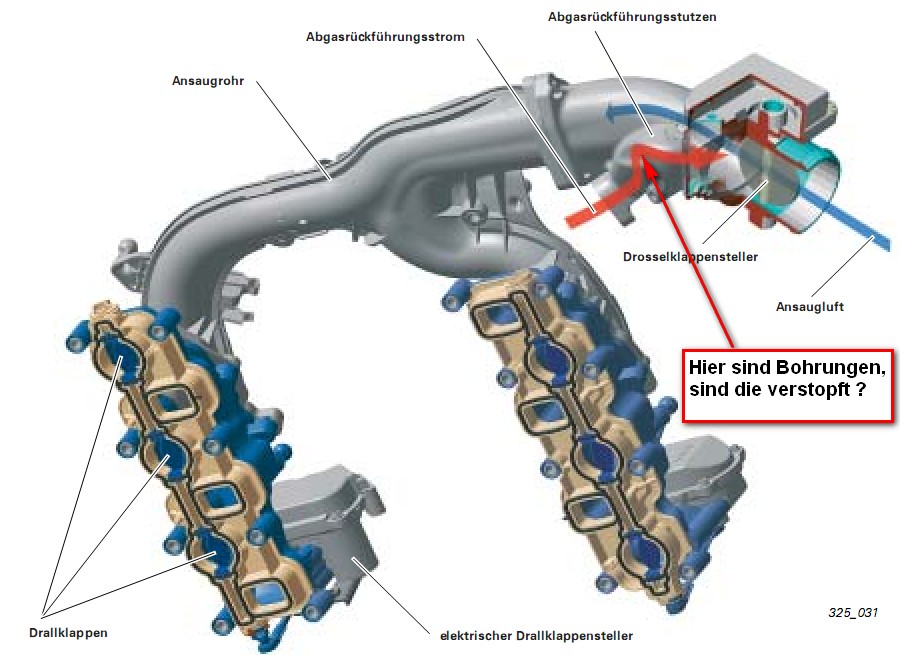

"That picture is great, where can I get something like that? Which holes are you referring to? To minimize the problem, I've currently reduced the EGR flow by using an aluminum plate with a 5mm hole. Without the hole, the engine check light comes on after a while. With the reduced EGR flow, the engine runs better."

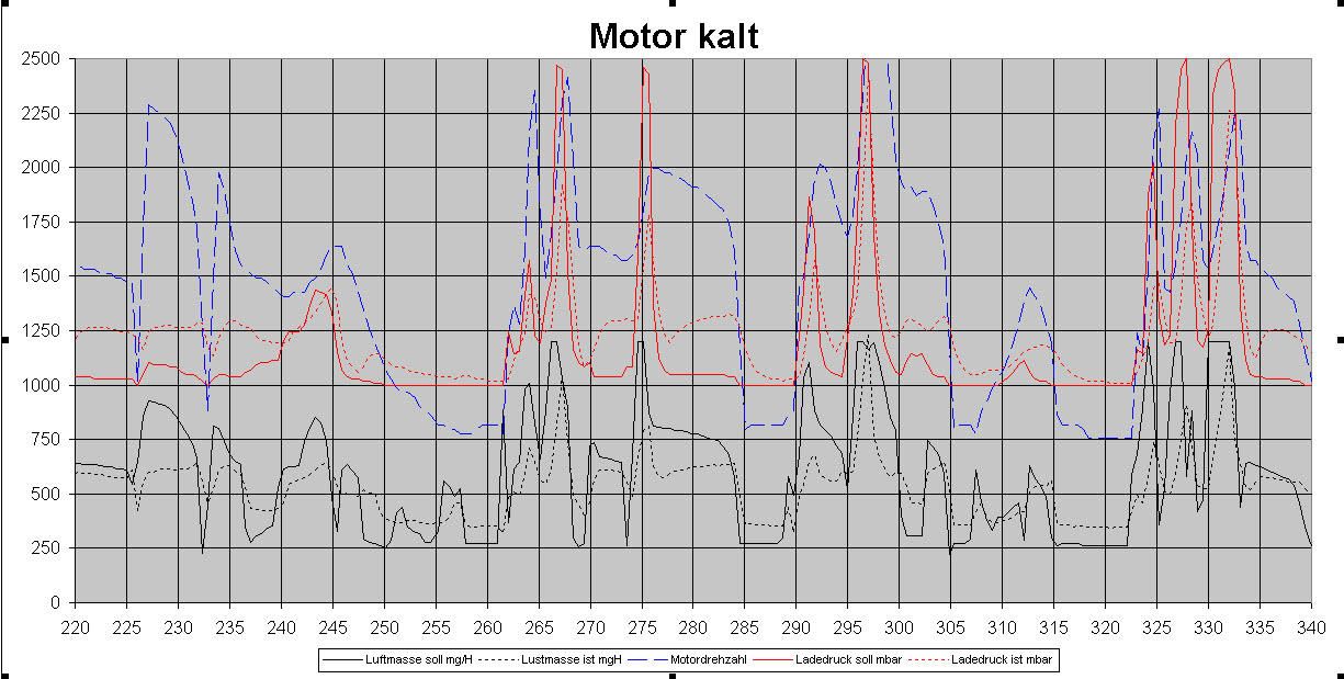

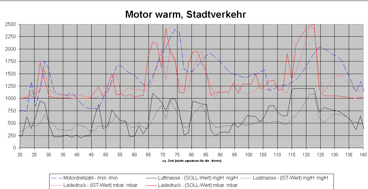

I have now recorded measurement curves in both cold and warm conditions.
In a warm state, one can observe, as expected, a significantly delayed increase in boost pressure.
What additional measurement data would be helpful in identifying the error?
