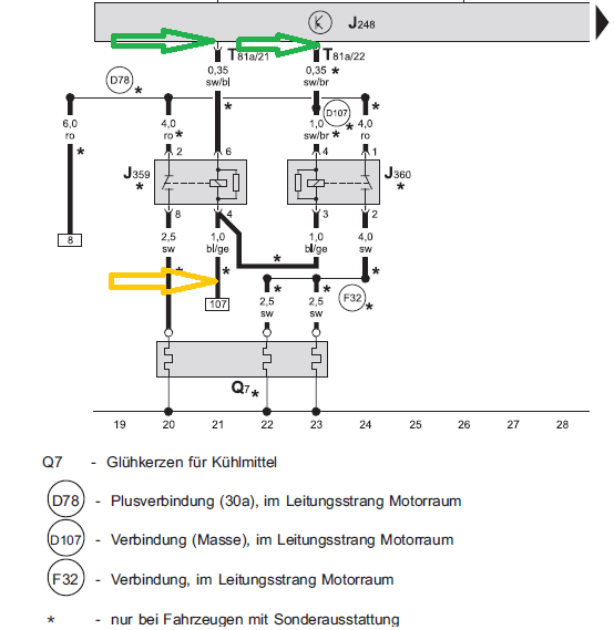

Okay,
I got some news, and today I was at a junkyard where I took the entire heating system from an A3 that had been in an accident, including all the wiring harness.
As I see it, this is actually quite simple. It goes from the relay box with a thick 6mm² cable to fuse 1 on the battery cover, which has a rating of 50A. I've completely removed that cable.
Okay, but now three power cables are running somewhere behind the water tank cover. I wasn't going to cut through everything, so I just clipped the wires off for now and will pin them out and replace them with longer cables at home.
Two thin wires, each with a cross-sectional area of 0.5 mm², go to the engine control unit; that much is clear. Another wire, with a cross-sectional area of 1.0 mm² and connected to both relays, goes to what is labeled as "power line 107," whatever "107" refers to.
Mir stellt sich nun die Frage, es ist der zweite Spulenkontakt - also kanns nur Plus (Kl. 15) oder Masse sein. Daher die Frage, was gibt das Motor-STG aus? Plus or minus?
Please refer to the attached diagram. The thin wires in green connect to the engine control unit (ECU), and the wire in yellow is the one I suspect connects to the ignition power supply.
And one last question for the experts: Does the GSK heating system need to be activated, or is it already active?

Post24-12-2009, 0:53    Subject: Quote
Ibiza1986 wrote:
... goes to the power path "107", whatever "107" is.
In the image below, each individual circuit path is also labeled. In your section from 19 to 28, if you turn a few pages further, you will find circuit path 107 (each column is linearly numbered with the number you've labeled as the "circuit path number"). In column 107, you will find exactly such a field that refers to this column 21 (which shows the reference to 107).
Then you'll know whether it connects to the positive or negative terminal.
"Another question: What is used to control the PTC? I always assumed that VW either uses glow plugs in the water circuit or PTCs. Since both have a high and low setting, and both are controlled by the engine management system (MSG), I thought they would use the same pins, meaning it could only be *either* *or*, but never both."
But so far, that's just been my assumption. I wasn't aware of any vehicle that had both features (e.g., Golf 3: only GSK, Passat 3C: only PTC, and even VW sometimes omits the latter if you have something else *grr*).

Hi there,
"Finally, someone who explains how the wiring works, thank you very much. I finally understand it and found it right away. There's a brown connector inside the water tank; that's where it goes in. That makes sense. Earlier today, I only cut the cables near the water tank because I didn't want to disassemble the unit further in the cold, and just now I crimped on some new wires."
The above is a GSK heating system. Q7 refers to the three glow plugs, where one (the smaller one) uses J359 for low heating power, and the other uses J360 for high heating power.
I just completely removed the flange from an Audi A3 today, including all the wiring harness, so that it can be installed into the Škoda as a plug-and-play solution.
The thing about the PTC heater is just a vague guess; I'm not really sure if it actually has one – but warm air definitely comes out relatively quickly.
EDIT: I can't find a replacement part number for a PTC heater; I must have been mistaken.
"Then the above installation should be relatively straightforward to carry out, but I probably won't get around to it until next year because I want to replace at least the screws and the flange gasket, and I can't go to the parts store before my vacation."
Translated on 21-08-2026, 10:22.

Hello everyone!
guste100 wrote:
... Another question: What is used to activate the PTC? I always assumed that VW either uses glow plugs in the cooling circuit or PTCs. Since both have a high and low setting, and both are controlled by the engine control module (MSG), I assumed that they would use the same pins, meaning it's either _one_ _or_ the other, but never both at the same time. ...
I'm not entirely sure myself, but I also share Guste's opinion.
Here's the translation:
"Another reason against using a PTC heater and coolant-based heat exchangers simultaneously is that the generator load – even mechanically! – is very high when the PTC heater is active, which in turn means the engine has to be fueled with more fuel. Consequently, this also causes the system to warm up much faster."
Merry Christmas from Munich!
