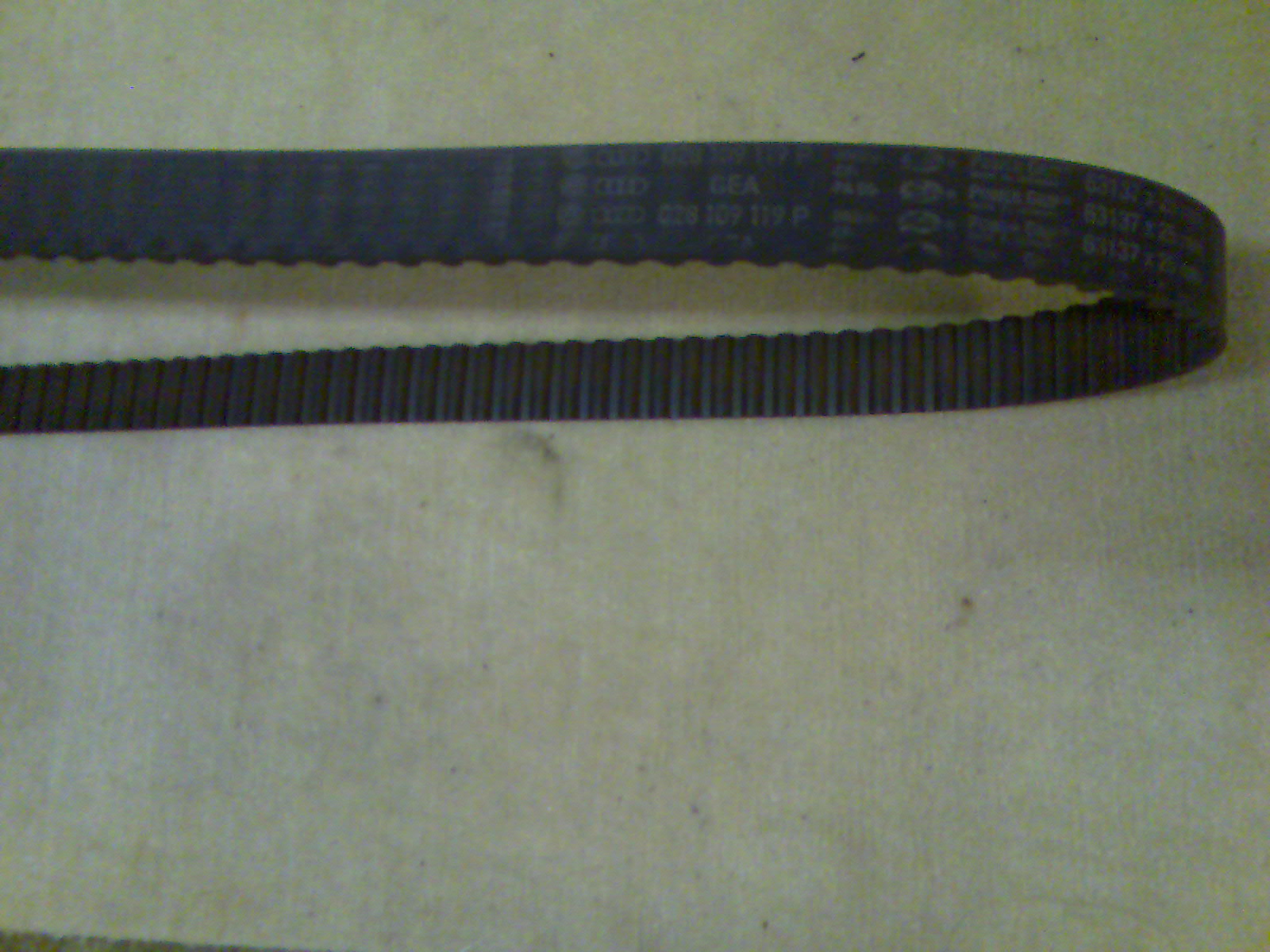

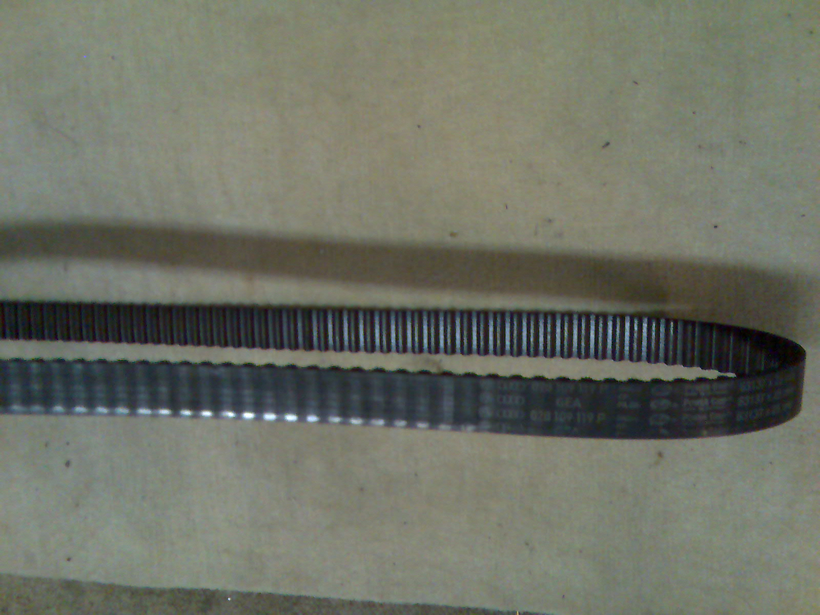

Post14-07-2010, 12:13    Subject: Contitech Belts: Photos After 90,000 km Quote
Wear and tear on timing belts in AFN engines typically occurs between 90,000 km and 180,000 km. Brand: Power Grip.
