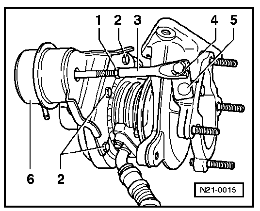

Rudi
Guest
Post09-06-2003, 19:34    Subject: Wastegate: AFB or VTG? Quote
Hi Garfield,
Let's see how the attachment function works icon_wink.gif.
The wastegate turbocharger also has a canister with linkage, but it looks completely different.
Best regards, Rudi.
