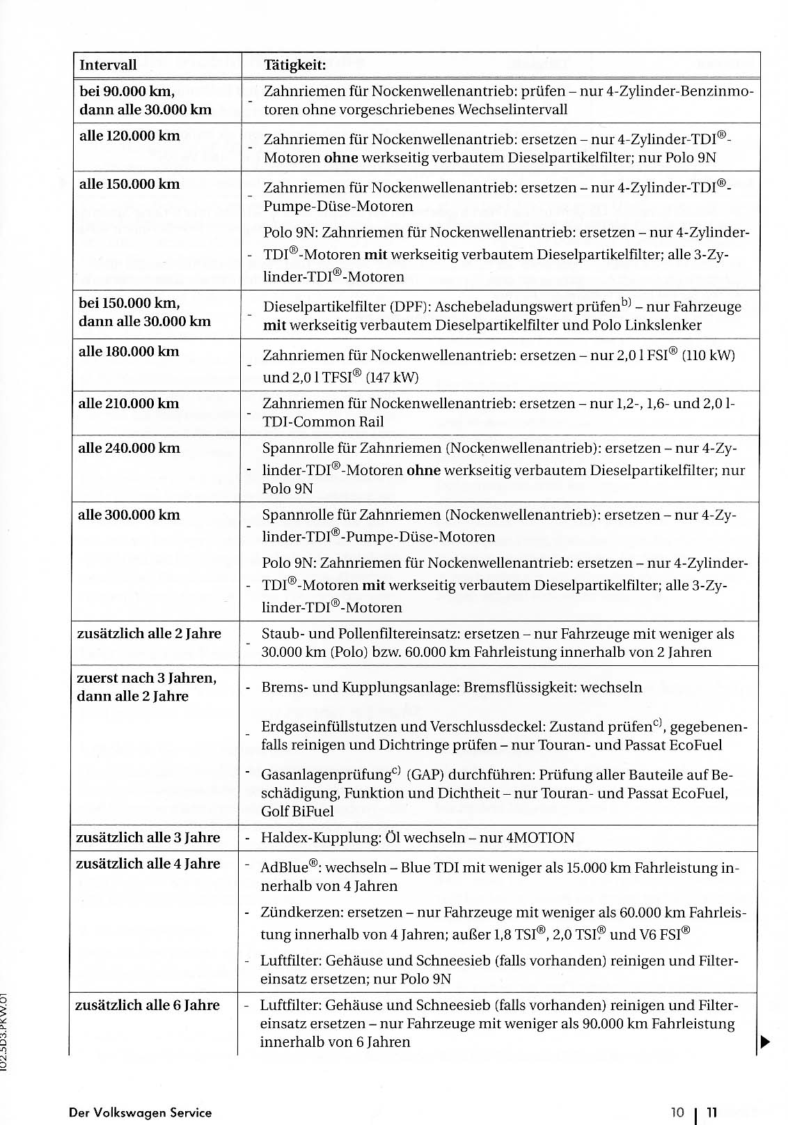

Post13-09-2010, 22:28    Subject: Quote
matthiasTDI96 wrote:
And now I'm bringing around the service booklet for the recently purchased VW Golf (service booklet printed in September 09).
Mine is dated August 19, 2009, came with my GTD from April 2010, and states that all CR TDI engines have a 210,000 km service interval, including the 1.2, 1.6, and 2.0 liter versions.
//EDIT In the Polo 9N, it's actually 300,000 km. An interesting differentiation icon_eek.gif.
 File size:  322.68 KB
 Viewed:  6808 times
Translated on 07-08-2026, 5:23.
Joined: 02/27/2003
Posts: 5886
Post14-09-2010, 7:34    Subject: Quote
"I don't have mine with me, but I can try to scan it tomorrow if I remember. That doesn't sound bad. Mine is also printed in Mexico, which explains the variation. Perhaps there were some information discrepancies during the transfer across the ocean...which would also explain things like the door panels on the Golf Variant or the missing new acoustic windshield."
Everything is quite strange...

Here's the service booklet from a fourth-generation Volkswagen Golf, printed in September 2009.
 File name:  IMG172.jpg
 File size:  852.97 KB
 Downloaded:  2548 times
Translated on 07-08-2026, 5:25.

Post15-09-2010, 10:12    Subject: Quote
VW has once again created the same confusing mess, just like with the AJM engine, where 60,000 km and 90,000 km were constantly mixed up icon_rolleyes.gif.
Translated on 07-08-2026, 5:26.
Joined: 02/27/2003
Posts: 5886
Post15-09-2010, 10:16    Subject: Quote
One can only hope that the correct manuals are included in the right cars... icon_cool.gif
