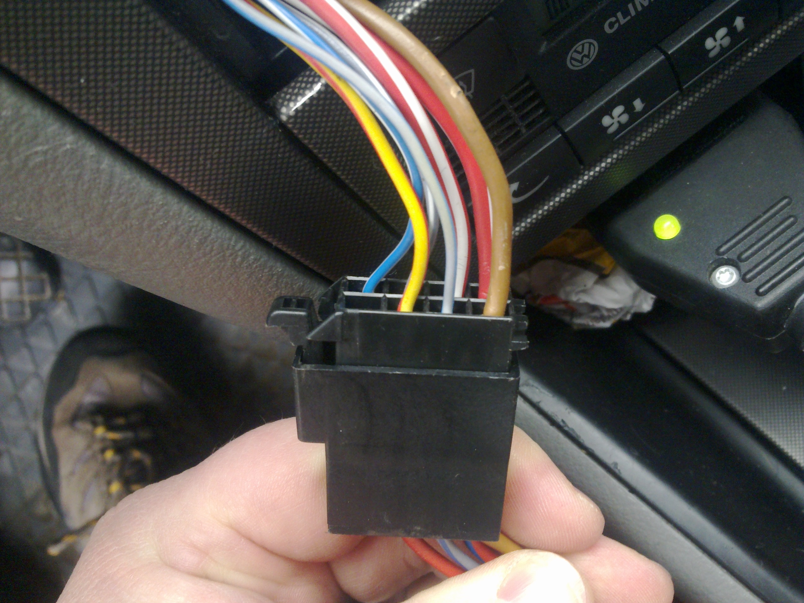

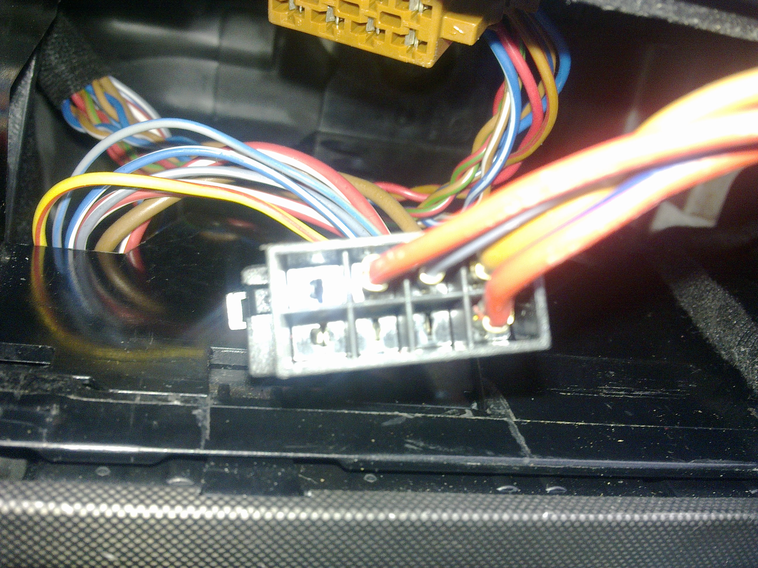

Post19-02-2011, 12:34    Subject: The Bora won't start Quote
Hi.
Bora is running again.
I removed the radio. I disconnected the battery. Error fixed, and it's running.
Even after several attempts to start, there are no more error messages.
Unfortunately, I can't understand why, but the K-Line (chamber 3) was not connected to the radio. An adapter plug was used, and it only had the power and ground wires connected. All other cables are not connected.
Let's leave the radio outside for now. Let's see if everything stays okay now.
Very competent and objective explanations.
Thank you for your help.
Regards,
Bolzer.
