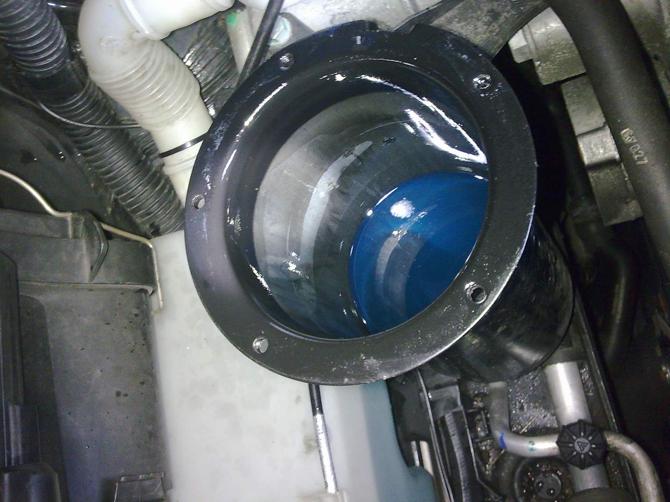

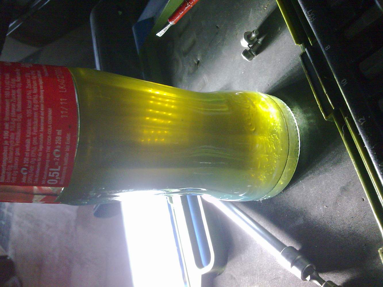

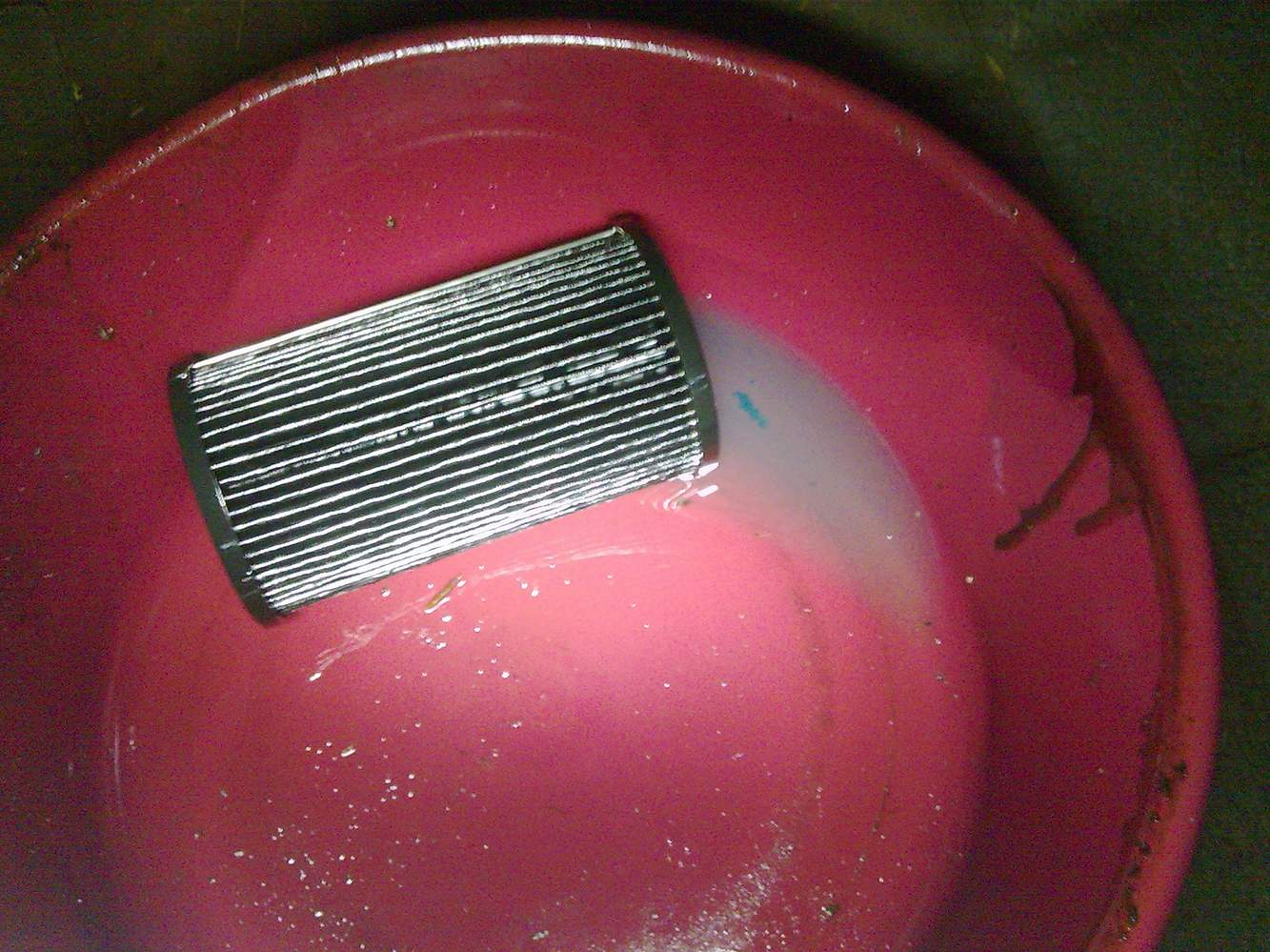

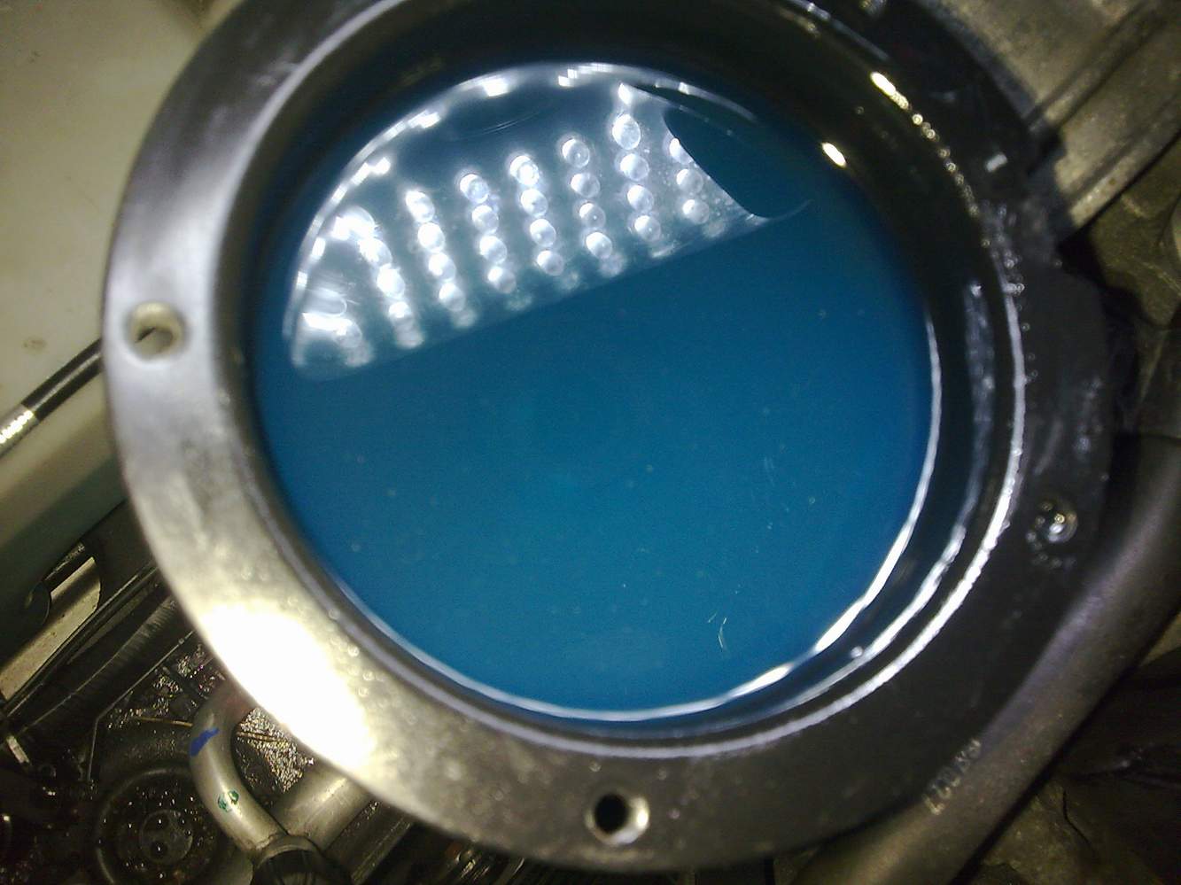

Hello.
'Today, I replaced the diesel filter on a 140hp common-rail A3 (with 80,000 km on the clock)... but the fluid that was inside didn't look very healthy.'
It looks kind of underwhelming for a diesel engine, doesn't it?
Okay, I just installed a new filter (shouldn't this also be replaced during the 60,000-mile service, right???)
Where does this come from?? Oil coming from the tandem pump? The engine oil level is slowly decreasing, and the oil doesn't smell excessively bad.
Can this be tested? I think there's a method that involves applying compressed air and checking for pressure loss.
Best regards,
Marc
I'm sorry to bother you again with something silly, but the forums where you can find helpful answers are few and far between...
edit:
The diesel fuel in the car is about 1.5 to 2 months old. Could it have undergone a permanent change if it was exposed to very cold temperatures for a while? (We had temperatures as low as -12°C about 3 weeks ago).

What exactly do *you* dislike about the diesel? Since you're not providing specific details about what makes you hesitant, it's difficult to comment on it.
I notice two things:
1.) The diesel appears slightly cloudy. What was the temperature of the diesel when you took the sample, and how long had it been at that temperature? I suspect these are paraffin crystals. It's not necessarily a problem if the diesel temperature reaches the cloud point, it just doesn't look very appealing.
2.) It appears that your diesel filter is full of black particles. In the second picture, you can see a small accumulation of black particles on the bottom of the red container, to the right of the filter.
What exactly it is cannot be determined by simply looking at it; it needs to be analyzed. However, I bet these are degradation products of biodiesel. But there's nothing you can do about it.

Well, what I don't like is that the diesel is so murky/dark... When you hold the cola bottle up to normal daylight, you can't see through it.
I was also thinking about the paraffin issue... the car is always parked outside. Does that mean the diesel has been below freezing for the past two weeks? However, I drove it 50 km before the filter change... I think the sensor reported something around 10°C after the change. Will it completely dissolve again?
What actually surprises me more is the black coating on the filter and in the pot... It felt kind of 'slimy.'

What happens if you store the diesel in the Coke bottle in a living room with a temperature above 20°C for a day? Will it become completely clear again?
If applicable: Normal paraffin crystals.
If the eye turns blue: Make it clear to the wife that this experiment will help secure her mobility icon_wink.gif.
The question is when exactly you refueled: Summer diesel becomes cloudy at slightly above 0°C, while a transitional product becomes cloudy around -10°C.
I actually don't find your diesel to be that bad. You could try putting it in the freezer: if it's summer diesel, you'll get a really nice, white paraffin precipitate at the bottom of the container.
The black particles in the red container: Are these individual, irregularly shaped particles with a diameter of a few millimeters that float freely when shaken, or is it a completely connected mass?
I suspect this is just normal biodiesel buildup. I would only worry about the tandem pump if your oil level drops significantly. Can the tandem pump actually pump oil into the diesel? I thought it only goes the other way: diesel into the oil, due to the pressure differences.
