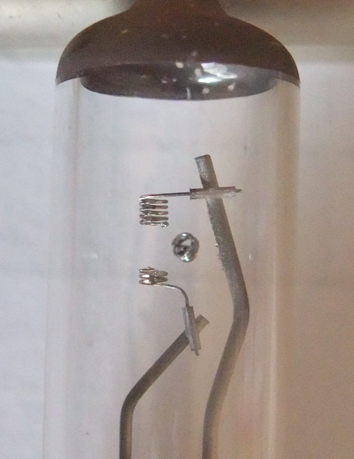

Post27-11-2010, 11:59    Subject: H7 Headlight Bulb: Buy Online & Save! Quote
Bertil wrote:
My forest ranger actually ate an H7 bulb. And that's at around ~48,000 km. For the permanent light function, it's actually okay.
Maybe also because the gasoline engine uses bulbs with less vibration than an ASZ, which rarely revs above 1700 rpm...
Here's a picture of the broken OEM Osram headlight bulb from the Polo.
If you like, feel free to offer suggestions as to whether it's more likely a "voltage surge" or vibration damage icon_wink.gif.

Post27-11-2010, 12:14    Subject: H7 Headlight Bulb: Buy Online & Save! Quote
Those who wish may feel free to offer suggestions as to whether the damage is more likely due to a surge or vibration icon_wink.gif

Post27-11-2010, 17:18    Subject: H7 Headlight Bulb: Buy Online & Save! Quote
@ ulf: The lamp shown in the picture has burned out. Due to use, the filament had degraded so much that the detached piece only needed a minimal nudge to fall out. There are always specialists who, after refilling the windshield washer fluid, turn on the lights for a function check and then slam the hood shut with a loud crash. It's strange, because just now the light was still working?! icon_evil.gif
"Your headlight looks very dim. That suggests it should have been working for quite a while. In my opinion, H7 bulbs also tend to lose brightness more quickly than average. I never noticed that as much with H4 bulbs. Over the summer, I used up my remaining stock of old headlights in my 206; some of them only lasted a few months. But I only had a period of about 5 weeks in the height of summer when the lights were barely usable in the morning. Otherwise, I don't see why I would need to drive with the lights on during daylight. And even those not-so-bright old headlights were sufficient for being seen in the mornings or in rainy weather."
