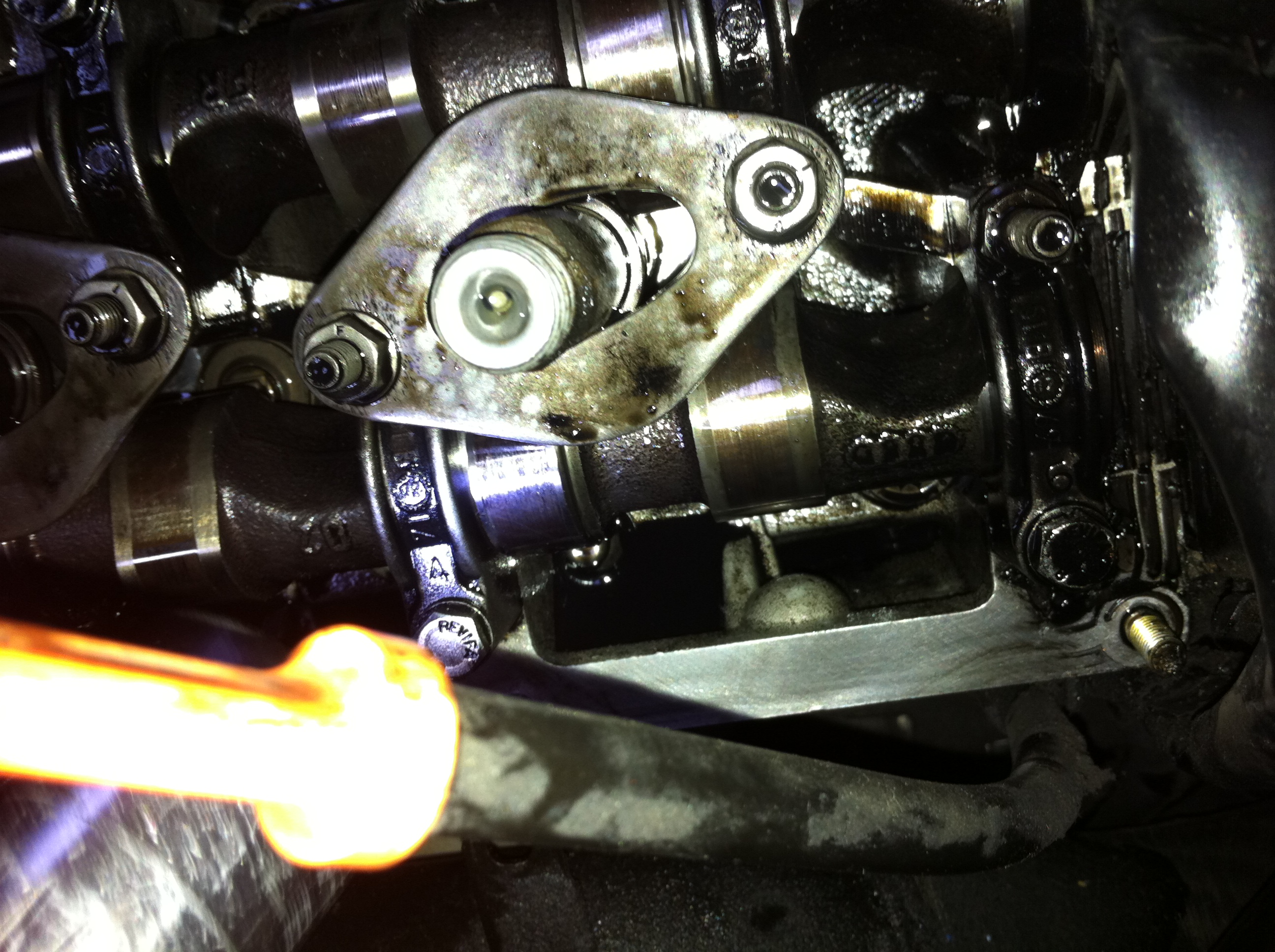

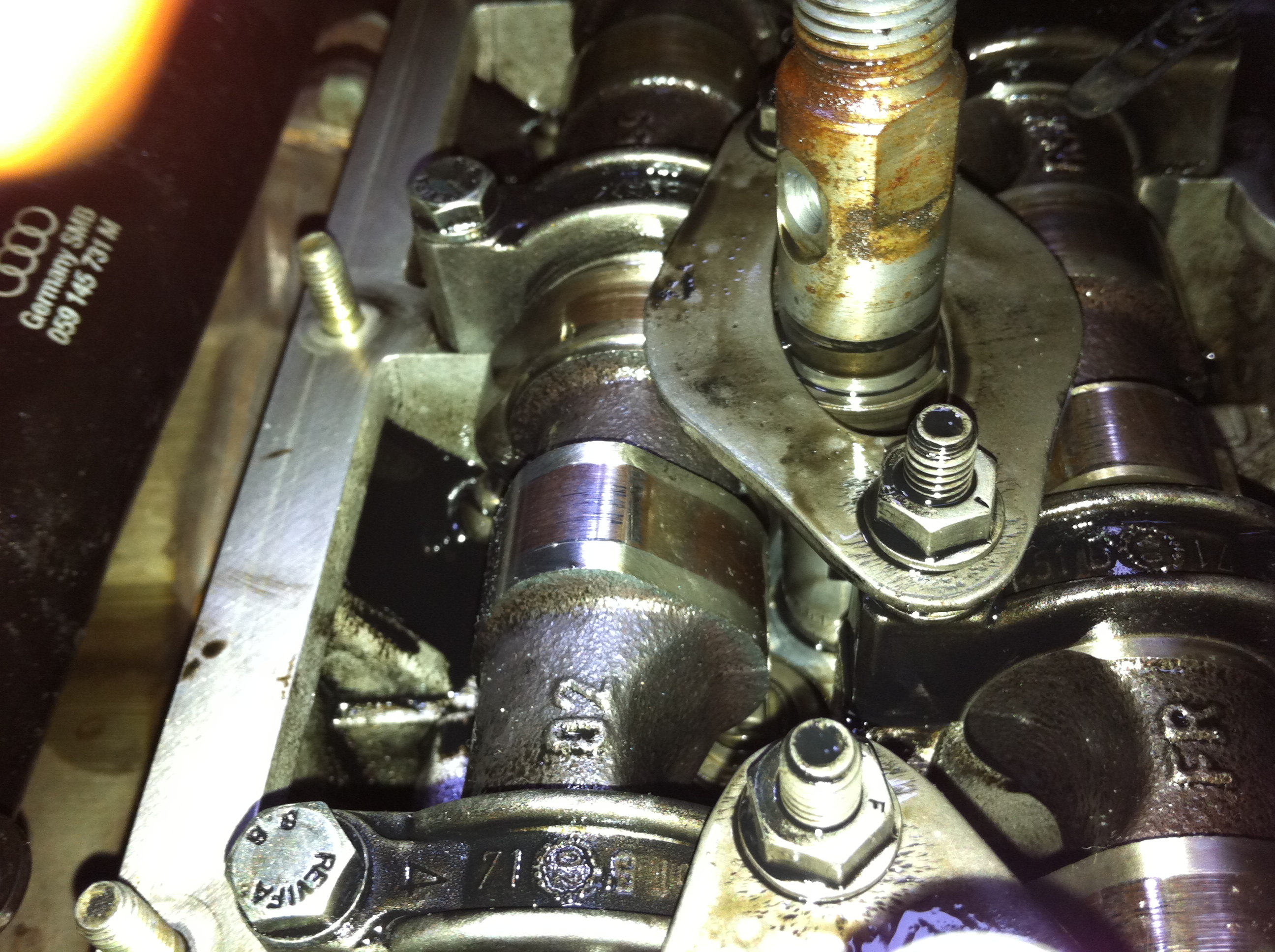

Post22-08-2011, 22:34    Subject: Quote
Okay, the results are in: The camshafts are worn, although not yet by 0.5mm, but the wear is clearly visible. We only removed the left cover, so it's possible that the right camshafts are in even worse condition.
'Also, three hydraulic lifters were also noticeable: they could be pressed in about 4mm with very little resistance, while the rest were hard. The engine was disassembled while it was still warm, but shouldn't any hydraulic lifter be harder than that?'
Since the 0.5mm wear limit hasn't been reached yet, I can only hope that the used car warranty will cover the replacement of the hydraulic components, so I can contribute the hardware costs for the new water pump.
Okay, current mileage: 78,000 km.
