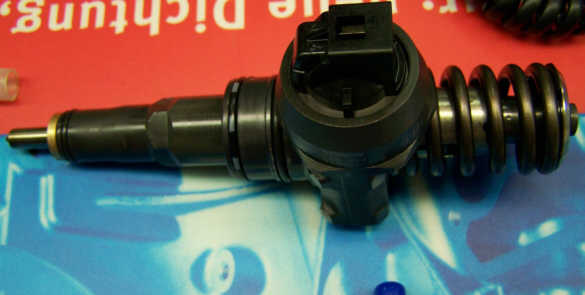

Starting around the year 2000, the older system only applies to certain AJM and ATJ models. If the PDE (presumably referring to a component) is ever replaced, the new version will always come with the plunger already installed. You just need to order the ball joint and locking nut, and it can be easily converted to the new system. With the 2003 ATD model, you don't have to worry about these things anymore.
Image 1 shows the old system. It can be identified by the pin that protrudes from the back. In the pivot lever shaft, there are sleeves similar to finger protectors that slide over these pins.

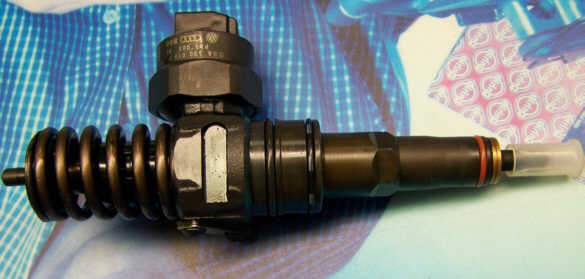

Image 2 shows a current, original Bosch replacement high-pressure pump (PDE) for the same engine. Unfortunately, the lifter is not particularly visible in the photo, but that's all I have for now.
