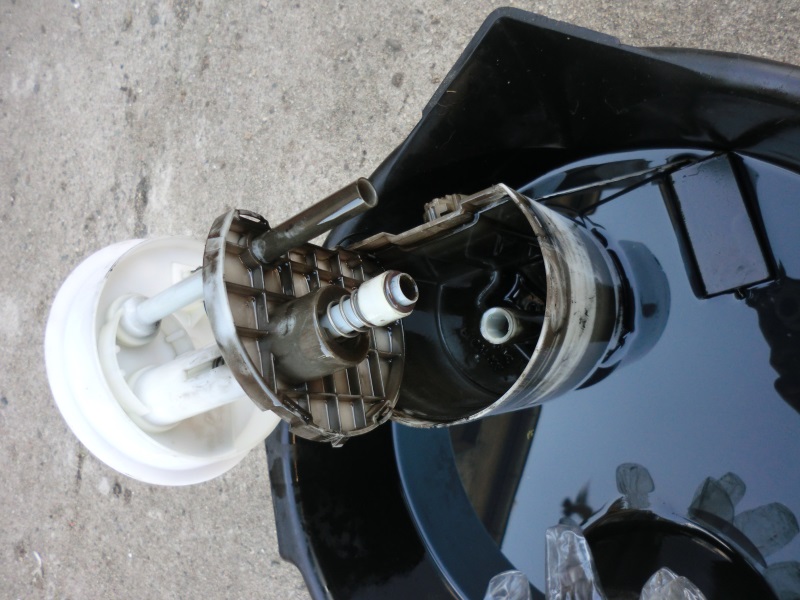

Post29-09-2013, 0:10    Subject: Quote
It took a while before I could do anything again. Last week, I ran out of gas again – with the tank about 1/4 full, even though I had already bypassed the fuel cutoff switch. Luckily, I had a 20-liter canister in the car, so it wasn't a major problem.
"Another (used) carburetor arrived today. I tested it by draining most of the fuel from the tank. I didn't see any air bubbles in the carburetor. The 25km ride home afterwards went smoothly. Let's see if the problem has been resolved."
There was an O-ring in the intake manifold that was a little stiff – at least compared to new O-rings, but it wasn't brittle or completely hard.
Bye.
peace
