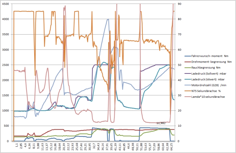

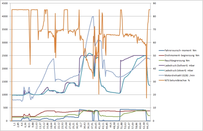

Post09-06-2014, 13:30    Subject: Quote
Argl.
While preparing, and now seeing that it's 33 degrees Celsius, I checked the logs and realized that I had indeed been logging the lambda values.
Lambda goes down to 1.982 (The graph shows lambda * 10).
Just to be clear, it still applies.
VTG could help, but it doesn't.
 File size:  155.65 KB
 Viewed:  1883 times
Translated on 17-10-2026, 19:06.

Post09-06-2014, 13:58    Subject: Quote
Unfortunately, I can't really do much with your colorful images.
But, if I understand correctly, the turbocharger boost pressure is lagging significantly.
Translated on 17-10-2026, 19:07.

Post09-06-2014, 14:19    Subject: Quote
Unfortunately, I can't really do much with your colorful pictures.
@dieselmartinViewing profile: dieselmartin: What's stopping you from attaching the log file?
