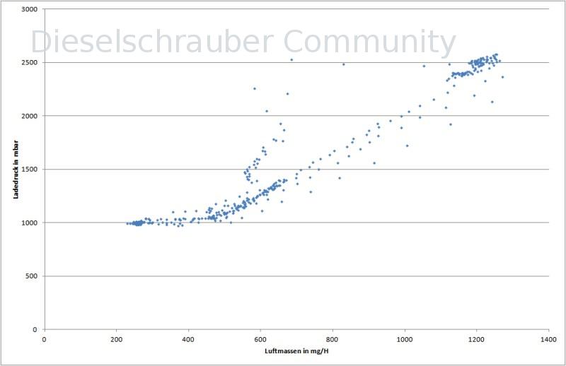

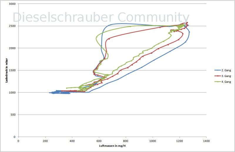

Post11-07-2015, 22:27    Subject: Quote
Sure.
It should roughly correspond to my diagram.
But the higher the gear, the smaller and more turbulent the air mass icon_exclaim.gif.
The data is from log file 2.3.4...003-011-043.

Posts: 18119
Post12-07-2015, 15:18    Subject: Quote
Where in your diagrams can one see the corresponding motor speed? icon_wink.gif
There's quite a difference whether it's running at 2000 rpm or 4000 rpm...
A few posts ago, I think I read something about a 500mbar differential pressure at the DPF. Could you please log the engine speed, boost pressure, air mass, pressure difference at the DPF, and post the .csv file? Charts like the ones above, without the engine speed axis, are nice, but they're not very informative.

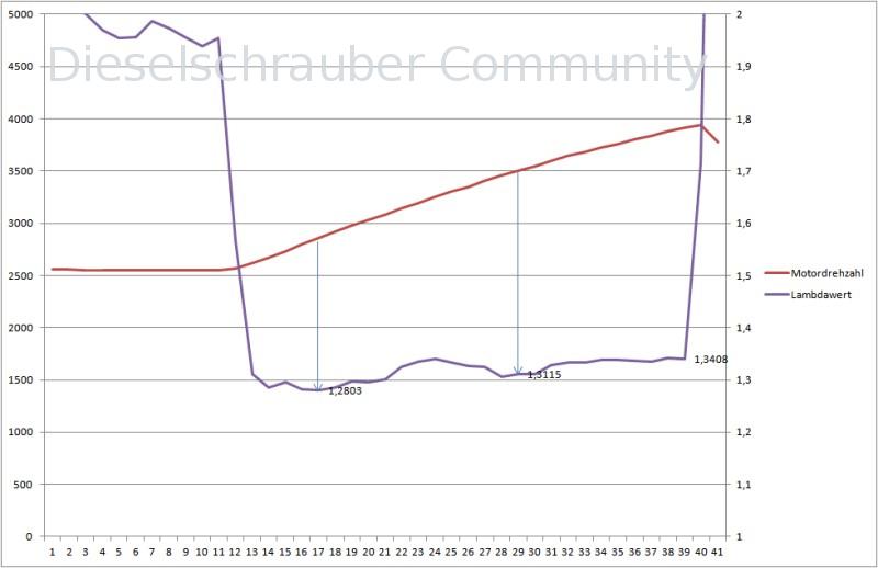

09/06/13 13.6 °C 29.1 °C
Here's a Picasso as well icon_smile.gif.
 File size:  38.95 KB
 Viewed:  418 times
