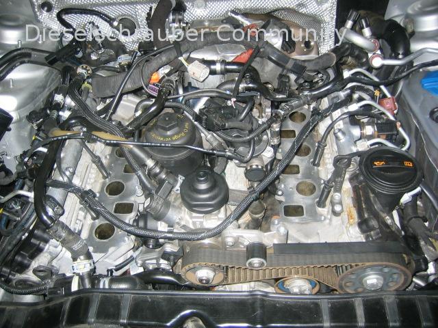

I just finished removing the intake manifold. I'll be sure to get back to you with my results once everything is put back together.

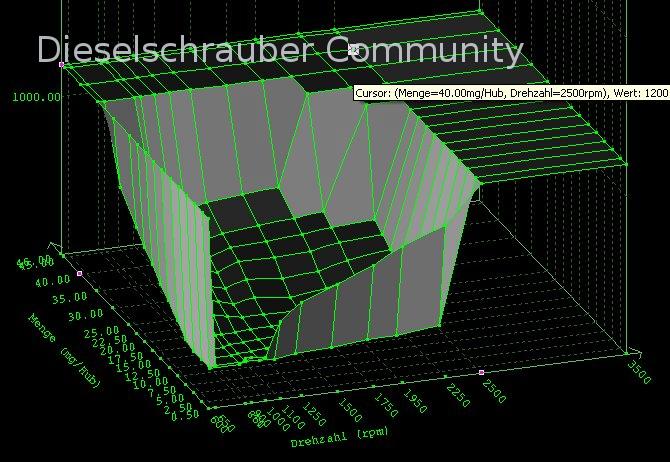

Air mass sensor target value, for EDC17 control unit in a Volkswagen Audi Skoda Seat (VAG) 3.0 TDI engine, software part number 8K0907401F.
There is no air mass control system operating outside of the low-load range.
Consequently, it's pointless to discuss it further. If you can prove the opposite is true for your control unit, I'd be happy to be convinced.

If I may add something else: the target value of 1200 mg/hub seems strange because it also appears at relatively low speeds and with limited emissions.
Above a certain load or engine speed, the EGR valve closes, and the mass airflow sensor (MAF) reading shows a fixed value, which is not used as a reference for control. Whether it reads 1200 or 1000 seems irrelevant; it's a fixed value, in my case, for example, 950. As far as I can see, the air mass is determined by the boost pressure and EGR rate, rather than being directly controlled.
Okay, let's do the measurements using the mass airflow sensor, oxygen sensor, and lambda readings. That should give us more information.

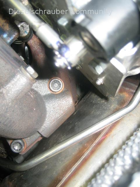

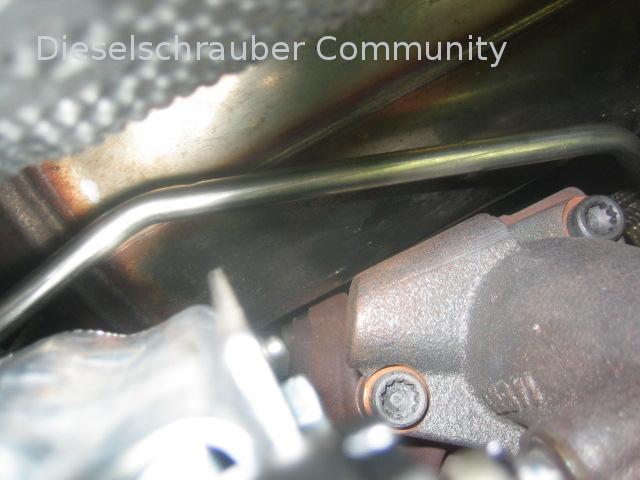

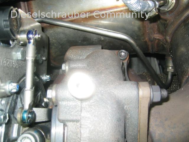

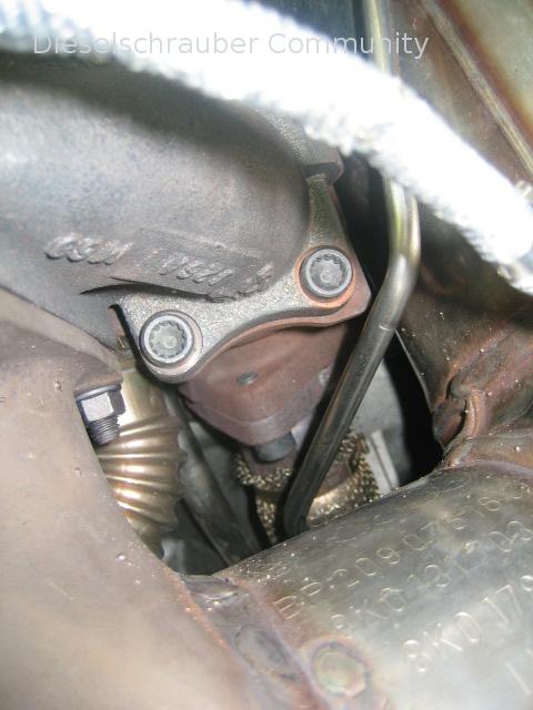

Here is a log with the suggested measurement values and pictures of the exhaust manifold/turbocharger (temperature sensor).
Unfortunately, I only got around to it today.

I would try mounting the sensor on the back of the vehicle and attempt to obtain data logs for parameters like engine speed (RPM), mass airflow, average fuel injection volume, and lambda value from a similar vehicle. This way, you could determine whether your measured lambda value is accurate or not.
Here's what you can do right now: Check the fuel temperature reading for plausibility, and also verify that the engine control unit is receiving a correct coolant temperature and charge air temperature (the latter should already be considered, but you never know what assumptions were made in the application).

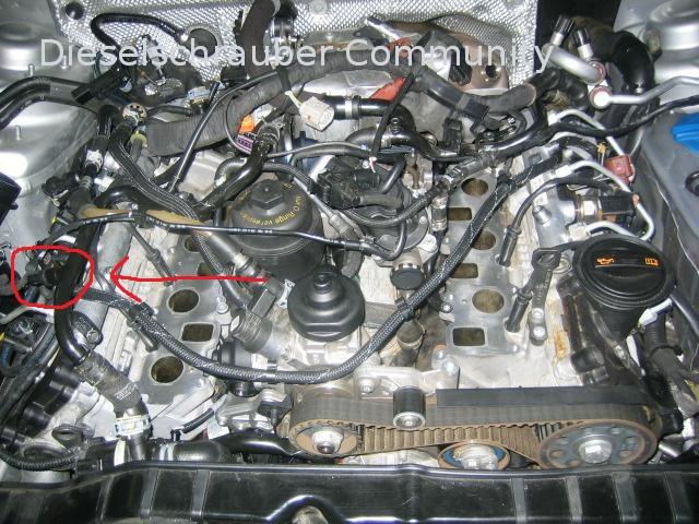

I think I just found the error! Edit admin: You don't have.
The temperature at sensor G83, located at the outlet of the intercooler (EGR cooling pipe), is only around 25°C (the target value according to VCDS is 90°C).
"When I unplug the sensor (which is reading 100°C), the radiator fan immediately turns on, and the engine runs much better under full load."
The temperature at the radiator pipe corresponds to the sensor value of approximately 25°C when the connector is plugged in.
It can't be the sensor, right?
If I disconnect the sensor connector while the ignition is on, the pump for the EGR cooler runs.
