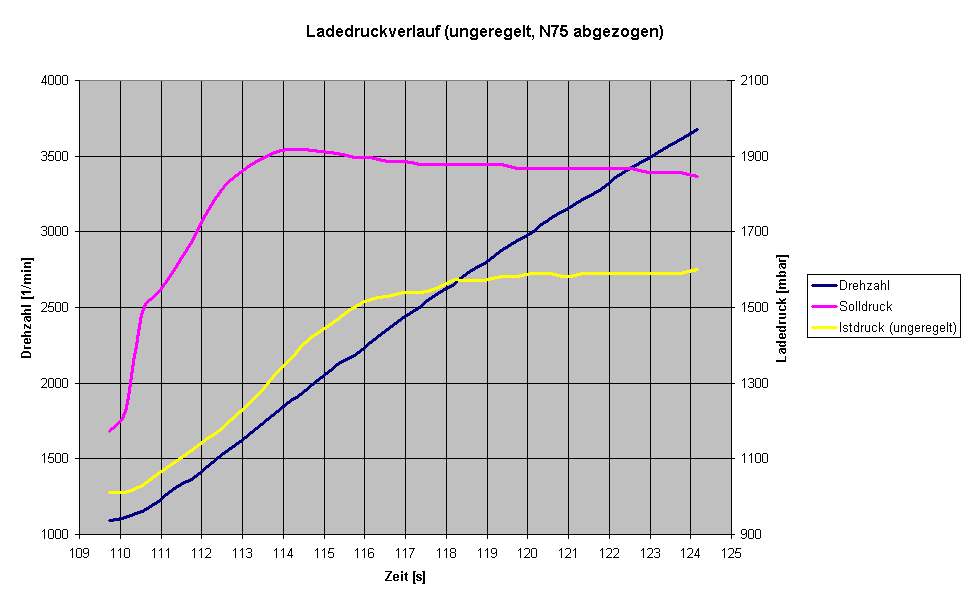

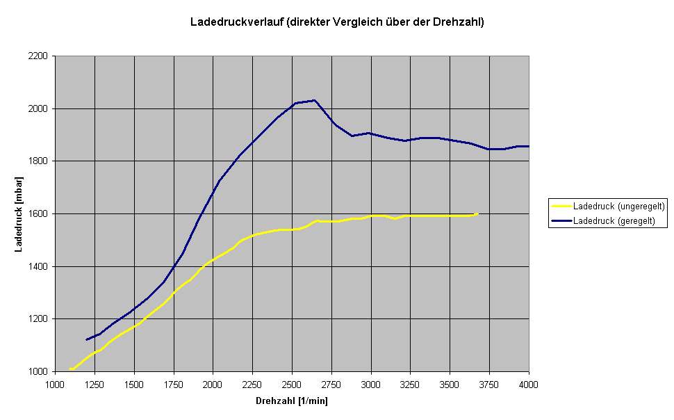

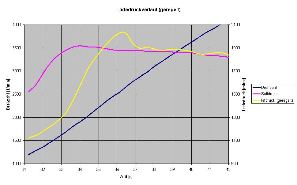

Post30-08-2003, 23:40    Subject: Quote
Hello fellow DIY enthusiasts,
I'm back from vacation and already conducted some measurements today.
Apparently, the approximately 1400 km of highway driving during the vacation trip had no effect on the engine's performance, as the maximum boost pressure is still reached too late (around 2600 rpm).
However, the Ulf's DZR test actually shows that my engine produces slightly more than the rated power of 66 kW (approximately 4-5% more power). This may seem contradictory at first, but it could be because the engine was already running very well from the factory, without any modifications.
Here are some figures regarding the vacation trip:
vmax = 200 km/h (according to the speedometer)
Highway intersection with very high traffic volume, approximately 130 km/h.
Average fuel consumption: 5.6 liters per 100 kilometers (with a brisk, anticipatory driving style).
Back to the technical details. I have slightly visualized the measurements I took and created three diagrams based on them.
The diagrams show the boost pressure behavior with active boost pressure control, with boost pressure control deactivated (the connector at the N75 solenoid valve is disconnected), and a comparison of the actual pressure curves over engine speed with and without boost pressure control. Please note: This is a wastegate turbocharger that is operated with overpressure. By disconnecting the connector at the N75, the valve bypasses the boost pressure directly to the turbocharger's pressure sensor, resulting in no pressure modulation and therefore no active control!
According to the repair manual, at 3000 RPM and full load, a pressure of 1550...1750 mbar should be achieved. The actual pressure is approximately 1580 mbar, which is actually within the acceptable range.
According to the repair manual, the target values with active control are also reached at 3000 rpm. However, in my opinion, the boost pressure build-up at low engine speeds is still inadequate.
This test, therefore, doesn't really provide any meaningful information.
What I find remarkable is the direct comparison of the boost pressure curves as a function of engine speed. The measurement conditions were ideally identical: a straight, level stretch of road where both measurements were performed (only in opposite directions). In each case, a full-throttle acceleration was performed in 3rd gear from a slightly elevated idle speed.
The regulated curve deviates upwards from the unregulated curve starting at approximately 1350 mbar, as the N75 valve reduces the control pressure to the membrane dosage system in this region.
According to Ulf's article, the membrane should not deflect until approximately 1600 mbar (if I remember correctly). Therefore, I would have expected the two curves to be identical up to around 1600 mbar.
Perhaps my nib has become lodged in the ink cartridge or has become loose. Has anyone else experienced this issue before?
Or could this indicate a leaky wastegate (slightly open in idle), because the unregulated maximum boost pressure of almost 1600 mbar should actually be reached at around 2000 RPM?
I also find it strange that the two curves are shifted parallel to each other in the lower RPM range, because there shouldn't be any difference there, right?
"Does anyone have any advice? How would you interpret these curves?"
Thank you in advance.
Regards,
Alex.
