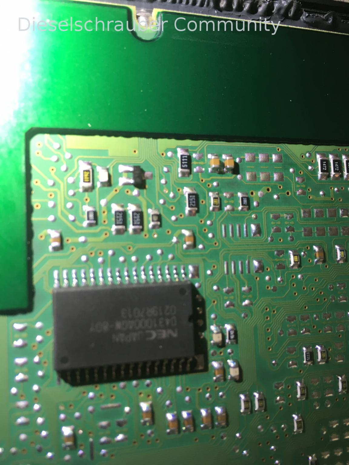

Thank you for your reply. The temperature sensors have been checked multiple times for plausibility, but unfortunately, they are all working correctly. I took a closer look at the engine control unit and opened it. I found a Japanese chip from NEC inside the Bosch ECU (see photo). Now I suspect that the RS 6 has been tuned, but I cannot confirm this with 100% certainty. Has anyone else here opened such an engine control unit? Unfortunately, Google is also not providing any information about the chip. I think I will first try using a different engine control unit, as I am unsure whether the data processing in the tuned ECU is reliable.

The chip you found is a 128k SRAM.
Full designation: uPD043100AGW-80Y.
It has absolutely nothing to do with tuning.
It is perfectly normal for an engine control unit (ECU) manufacturer to use electronic...
Components are used that are available on the global market.
At SRAM, NEC was one of the few manufacturers.
