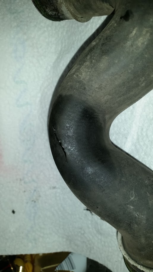

I have a question about a Passat 3BG, model year 2005, engine code AVF, with 411,000 km on the odometer.
Since the tandem pump was replaced (due to a leak in the vacuum pump).
Increased smoke production during acceleration.
The error memory is empty, and the performance is acceptable to me.
Is there a possible connection to the replacement of the tandem pump?
As far as I understand, too much soot would mean there's not enough air.
Air mass meter readings between 250 at idle and a maximum of 1230.
Boost pressure up to 2100 mBar.
Initial inspection of the intake manifold revealed no issues.
How can I narrow down the problem / find a solution?

So, 1230mg/hub @ 2100mbar don't match, which means you have a leak in the charge air duct. icon_wink.gif

The car needs an intercooler piping that runs horizontally across the front, underneath the radiator, to the other side. Please check the bends in that piping for any leaks.

So, 1230mg/stroke @ 2100mbar don't match, which means you have a leak in the charge air duct. icon_wink.gif
Which air mass would be appropriate here?
Translated on 24-09-2026, 19:13.
Joined: 02/22/2009
Posts: 3865
Post08-08-2016, 22:00    Subject: Soot Formation in AVF Engines Quote
It obviously depends heavily on the speed, but it definitely shouldn't be more than 1050mg per stroke.

Right, 1230mg/stroke @ 2100mbar simply doesn't fit with the OEM hardware for that engine, regardless of any chip tuning. icon_wink.gif
The loader is actually applying significantly more force, but that force isn't reaching the sensor.

Yes, Michael and Rainer's assumption was correct: there's a 2cm crack in the pressure hose located behind the turbocharger.
new hose 3B0 145 828 G, 113 Euros at the official dealer icon_sad.gif.
The engine is completely stock, with no modifications.
Thank you for the help icon_smile.gif.
