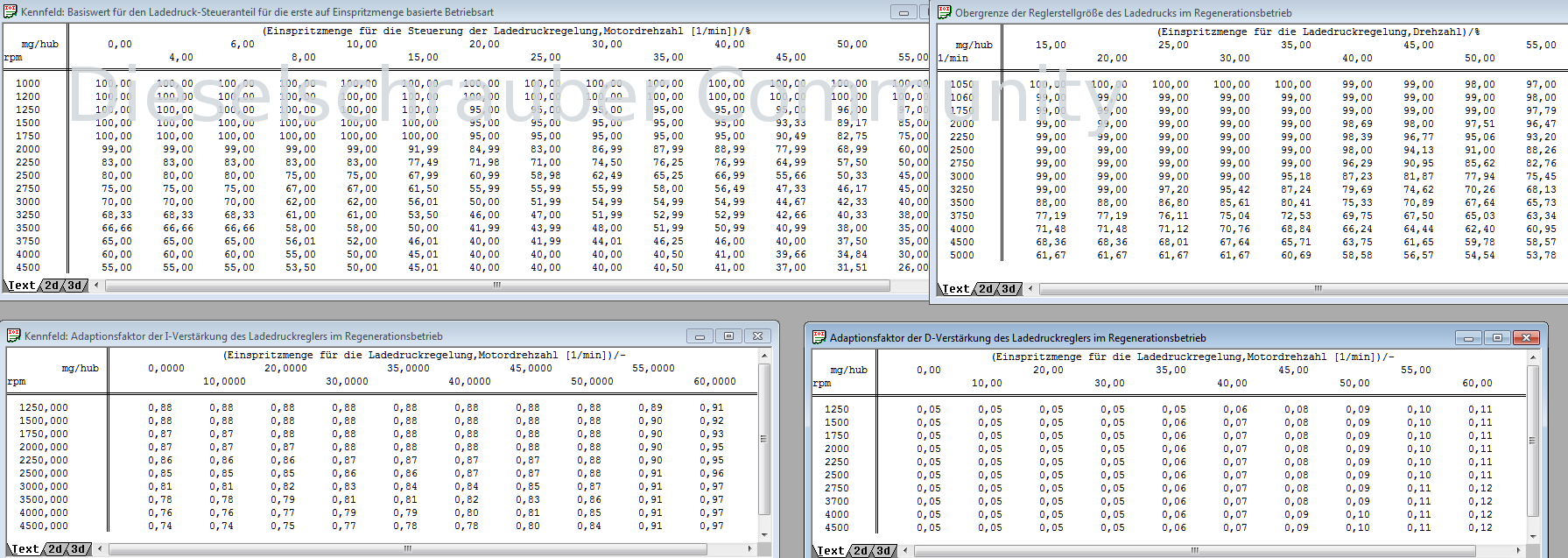

Normally, with an EDC17 system, 100% corresponds to full vacuum pressure in the can, which is a maximum of LD (lambda), and 0% means no vacuum at all. And that seems to be what's happening with you; at timestamp 152, you have 95% activation, and the LD value is accordingly high.
What about the throttle valve and the EGR system during regeneration?
The image shows the control parameters for boost pressure and the PID parameter tables.
It's from a CBBB engine with 170 horsepower.
